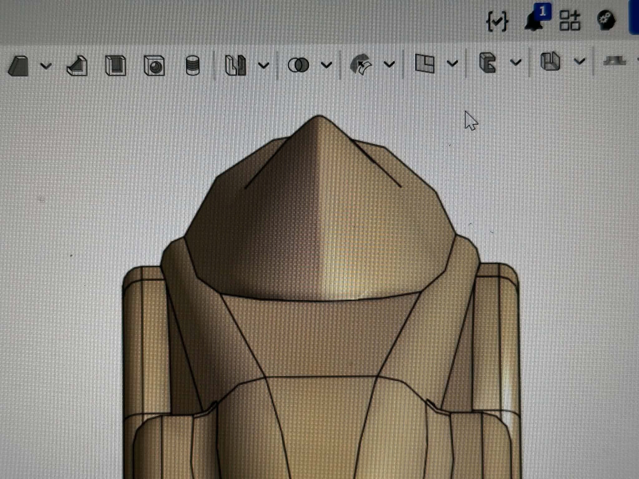

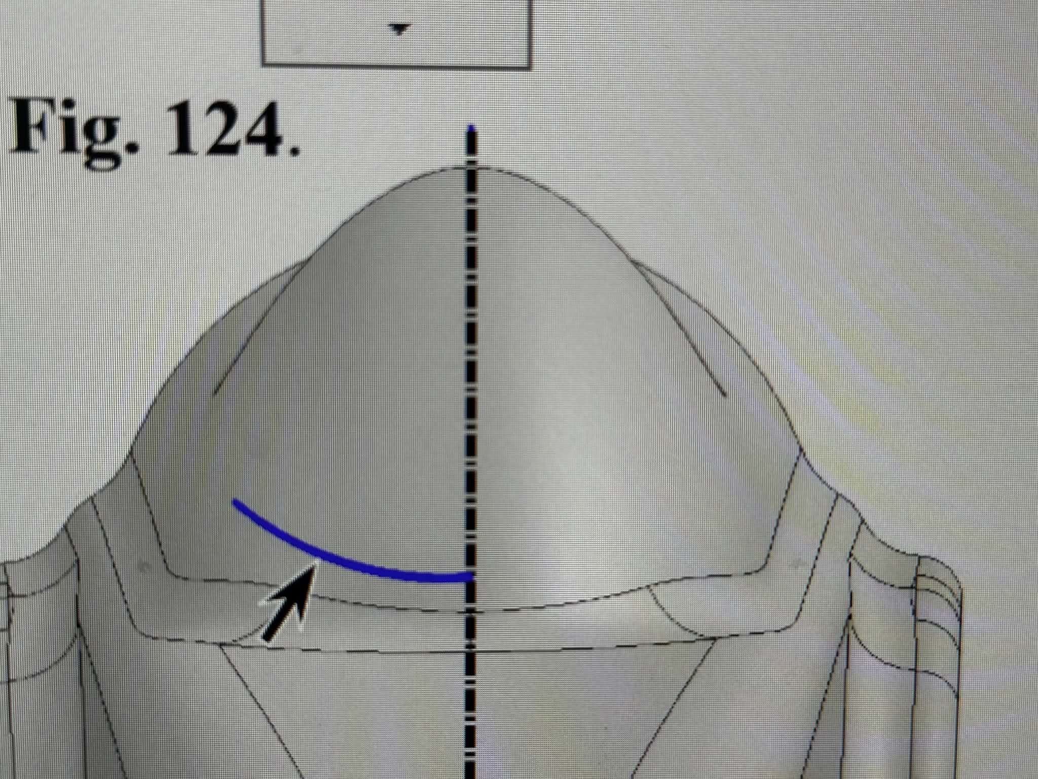

How to make lofts with guide curves smoother like other CAD software?
In the grey model is a loft made in SW 2025 with 3 guide curves; One on either edge and one over the top. In the beige model is the same loft with the same dimensions made in onshape, but here it creates a sharp, bumpy ridge instead of a smooth curve. Using normal end conditions on top curve does nothing. I know onshape isn't as loft-centric, but this seems like it should be possible, so does anyone know the trick?

    did you not use the same guide curve over the top?
  • martin_kopplow
    It is hard to tell without the actual document. I have done such lofts in Onshape and I know it works, though. This one looks like it should be an easy case. Besides guides, there are more options that shape the resulting surface, though. Did you activate any profil locking or did you use the spline/path option?
