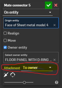

Anyone finding a use for this new feature in mate connectors? I can't say I remember reading anything about its arrival and I don't really see a definition for it in the help system.
I think I understand what it is allowing us to do but, I'm not certain I understand why I would want to choose which entity on the part the mate connector is attached to. What is also throwing me for a loop all the time is, sometimes when I select where I want the mate connector, this option will automatically unfold and preselect a face to attach to, sometimes it won't, and sometimes it will select the owner option. I am not picking up on what this new functionality is providing other then making me feel like I have somthing extra to worry about everytime I create a mate connector to be sure its doing what I'm not even sure I want it to be doing. 🤨

    It's very useful when adding explicit mate connectors to parts (or sketches) where the "origin entity" isn't on the part (or sketch). I use this often. If you only ever attach MCs to physical locations on parts, it's likely that this will seem superfluous, but if you like to add MCs in space as a common coordinate system for several parts - which may not even touch in the assembly - this is incredibly helpful.

    @S1mon I'm not sure I understand. How is the setting different from placing a mc on the origin and selecting which part is the owner? @GregBrown Do you know where this mc functionality is documented?

    You can place a MC on a sketch entity, but have it owned by a part.
    It wasn't always possible to have MCs that weren't attached to parts or the origin. Then they added MCs to sketches. Then they made it so you could place the MC on anything and have it owned by something else. At least that's my memory of the progression.

    It's very useful for Part Studio with no parts. Like Master Skeleton that drives other parts/assemblies. When you insert the sketch as a component or derived part, it brings along all the child Mate Connectors

    This worked even before the attach to option. We can select a sketch face as the owner entity without having to use the second option. Iv been doing it for years. I will get on my PC to check @lana example. Thanks for all the feedback.☺️

    Well, for me it is not so much having a use case FOR it, but in certain cases a problem WITHOUT it. ;0)
    One such case is when using the transform feature with the "by mate Connectors" option. That would have left an orphan MC behind.

    Thanks @lana I see what its doing now and, now it seems rather obvious that that's what it means. This is really useful and I will purposefully use this all the time now. I often transform stuff around and it is annoying to have to select the mc's as well so they go for the ride. 😁
