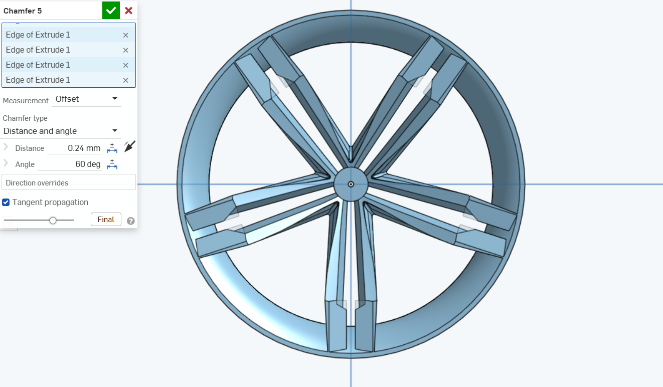

Chamfers acting inconsistently on a repeated feature?
Hello, I tried to add chamfers to this repeated feature but for some reason they look different on the bottom pair of spokes. I checked to see if I missed something on these spokes or added something the others don't have, but I swear they're all identical. Why is this happening? Is this a bug, or is there something crucial I'm missing?
    S1mon Member Posts: 4,602 PRO
    You need to either pattern a 1/5 (or even 1/10) of the wheel, or use the "Direction overrides" to help Onshape get the Distance/Angle reference correctly for all of them.
