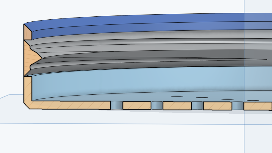

  • robert_reese196robert_reese196 Member Posts: 5
    Is it just me, why am I not seeing more of the options I've seen in other people's screenshots? I really need to be able to change the angle of the thread to something like 45 degrees so I can print it without supports.
    Thank you! This might be exactly what I need. I don't see any adjustment for the angle of the threads, but I assume since it has 'plastic' in the name is generating a thread that can print without supports. We'll see.
    Perhaps I'm using it wrong, but it seems to be making threads that are less printable because it's taking the depth all the way to the outside face.
