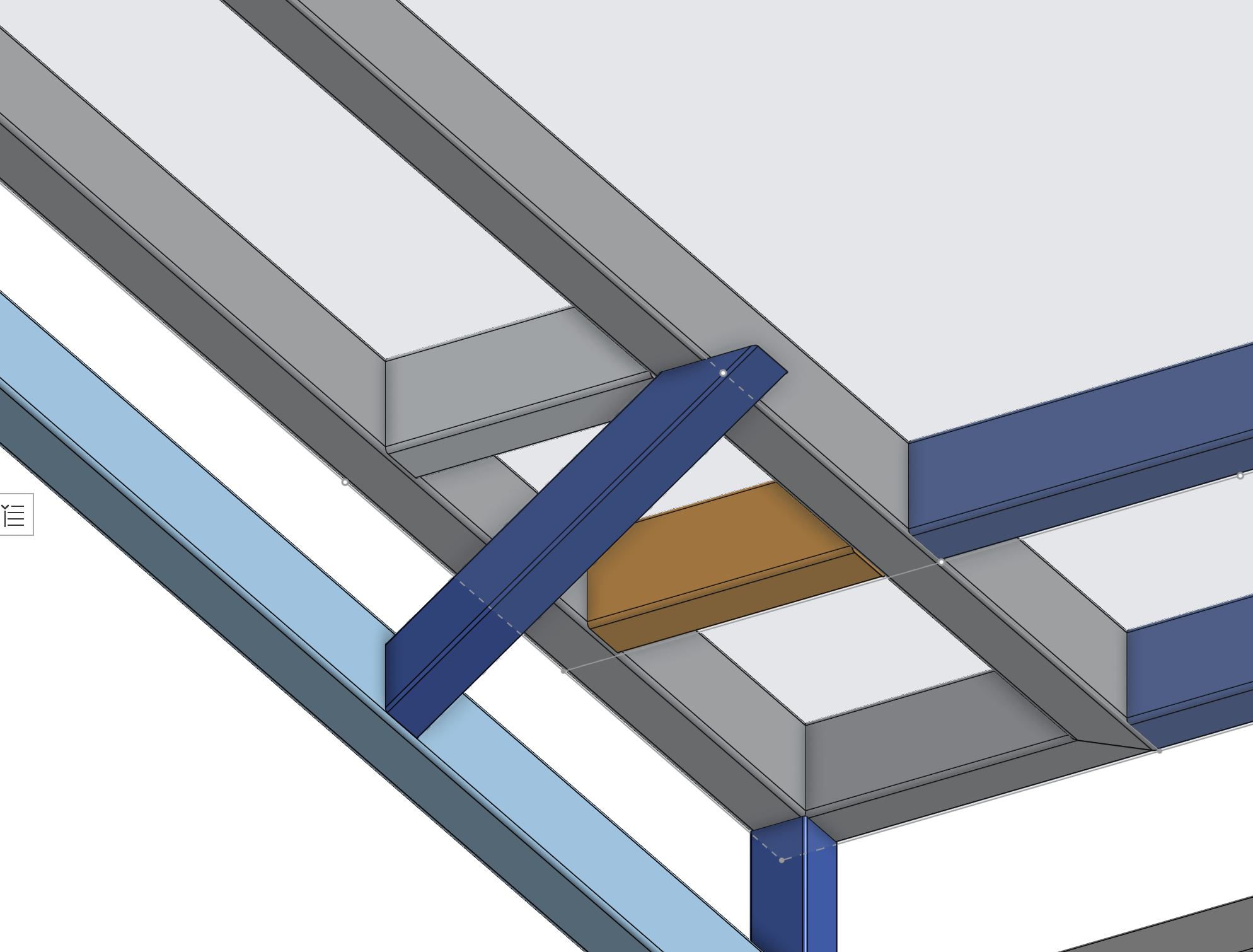

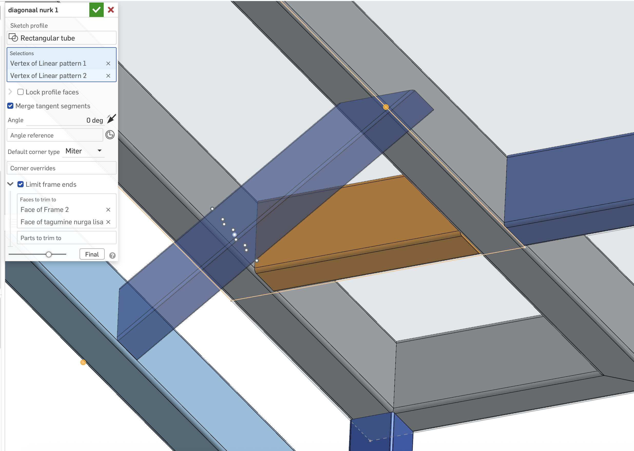

4. When using frames, I can adjust where the frame is situated along the points (not sure how to call this gizmo, pictured below.. How could I choose different points for both frame ends, so I could limit the diagonal parts upper end to the frame (the overall angle needs to change as well). Ideally I would like to avoid making new points to the sketch and doing it manually, since changing the profile later means I have to re do this.

. - For choosing a different start orientation and end orientation of a frame you will either need a custom feature, or you could manually create a fit spline between the diagonal corners of an untrimmed frame, then using mate connectors and the transform tool, transform the frame to the new diagonally based orientation.

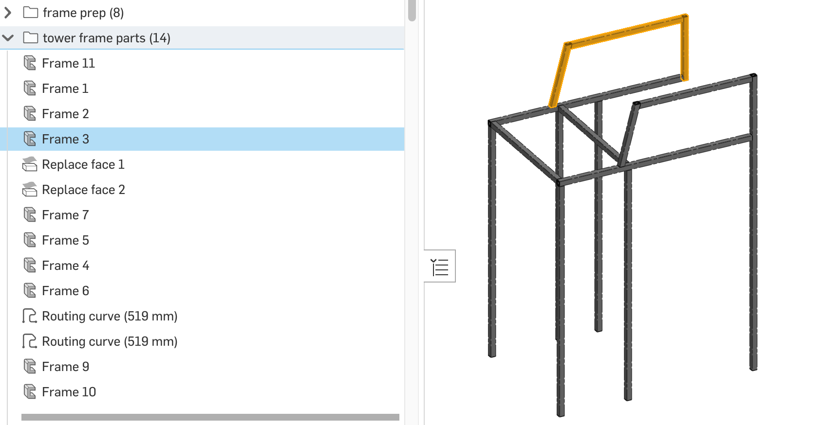

I never used any other CAD system besides Onshape for Frames, but one of the things that prevents me from using a single Frame feature for my current project is that there's no way to individually set the locator points (defaults to 9 points) for each of the paths. Frame also won't handle certain topologies. I'd like to do more with a single Frame feature for a bunch of reasons.

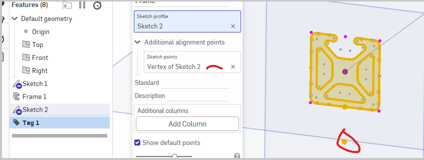

You can add locator points while making a tag feature.
The only way I know for adding to existing frame tag is to make a fame from existing and copy the end profile with new points added.

The issue I'm having is that this frame took multiple Frame features because I couldn't choose different points for different frame elements. Also the topology drove me to need more Frame features than I would have liked. In a few areas I could get several frame parts in one feature (see highlighted feature), but overall it was awkward. I suppose if I had started the reference sketches to all be on the center of the tubes it would have cut down on the complexity. But I wanted to reference corners which don't always work out neatly to be the same for all the elements.Simon Gatrall | Product Development, Engineering, Design, Onshape | Ex- IDEO, PCH, Unagi, Carbon | LinkedIn

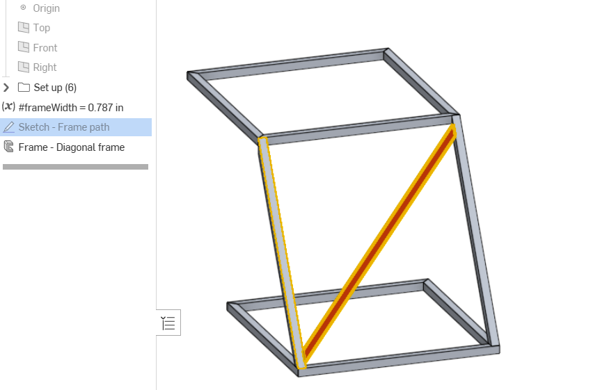

- Regarding the manual way of doing it: After thinking about it further, the best way to do this manually will probably be to create a guide sketch then use that to drive the frame path, like this. Remember to use the Cutlist feature to get a list of all the sizes. There is a default one, as well as a custom one I made for naming the frames and getting more data to the drawings: Cutlist+
