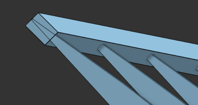

Below is an image of the trailing edge of an RC plane wing:
The trailing edge is twisted when wing washout is applied which causes problems with what I want to achieve below:
  1. I need to split the ribs at the front face of the trailing edge and then delete the rearmost parts post split.
  2. I'd like to make the trailing edge profile match the rib profiles.
I did ask the AI Advisor this question: how do I split parts using a twisted face
And the answer was: Sorry, Onshape AI Advisor cannot answer this question.
Any help appreciated.
Thank you.

  • Matt_ShieldsMatt_Shields Member, Onshape Employees Posts: 968 PRO
    You definitely don't need a planar face to use Split Part.
    Split Part doesn't work? Maybe share your doc.

  • graham_lockgraham_lock Member Posts: 265 PRO
    Thanks everybody.
    @Matt_Shields , no it doesn't work when the face is not planar.
    @MDesign yes that is an approach I'm looking at.
    The @GregBrown videos are very useful, thank you @eric_pesty and @S1mon.
    Thank you @Matt_Shields, you're absolutely right! Not sure where I was going wrong before!
