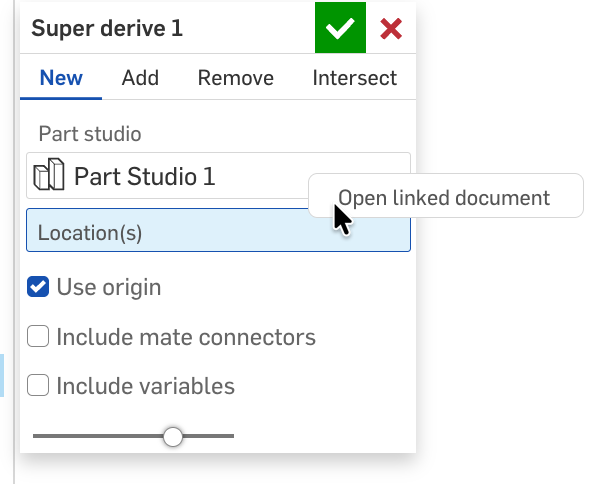

I don't see an option for "Open linked document" with Super Derive as I see with Derive. Is that because Super Derive is a Featurescript and doesn't allow for that functionality?

Need this for Amalgamate. Digging into it.
Edit: wait, Amalgamate already has this. Maybe it's just a featurescript version number thing with PartStudioData where older versions didn't support it?
Edit edit: It's not even a featurescript version thing, I think it's a document version thing. I just copied the exact code from Super Derive and got it working in a fresh studio. To get this to work I think all that needs to happen is for @NeilCooke to update the Super Derive document to the latest version of Onshape and push a version and you'll get the ability to open links back to the reference.0 -

@ry_gb I have versioned the document. I tried to change the FS version number to the latest and it threw an error, so if it works for you I will leave it as-is, but if it doesn't i will look into it further,

It worked on Mobile, so I'm gonna call it good. I'll check tomorrow on Web, but I think it should be alright. Thanks for the quick reply!

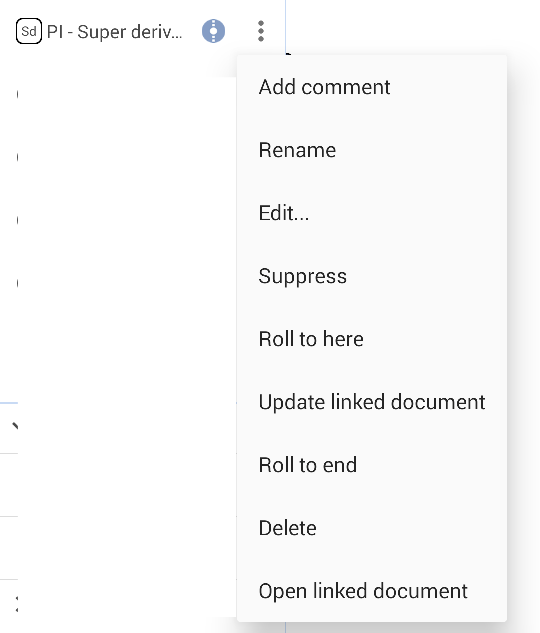

@NeilCooke now that's weird. It totally works on Mobile, but I'm still having issues on Desktop. Here's the mobile screenshot. Open linked document opens the derived document.
Ramon Yip | glassboard.com
@Derek_Van_Allen_BD hmm, very interesting. I've pushed an update with the latest std version, so let me know if that works for you. I'm glad your company finds my features useful!
FRC Design Mentor - Team 1306 BadgerBots0 -
If you can get to an edit dialog. Our company has a ton of light users accessing documents that can't click back through the document chain to find the source of a hole pattern that's ruining their morning on the fabrication floor.
