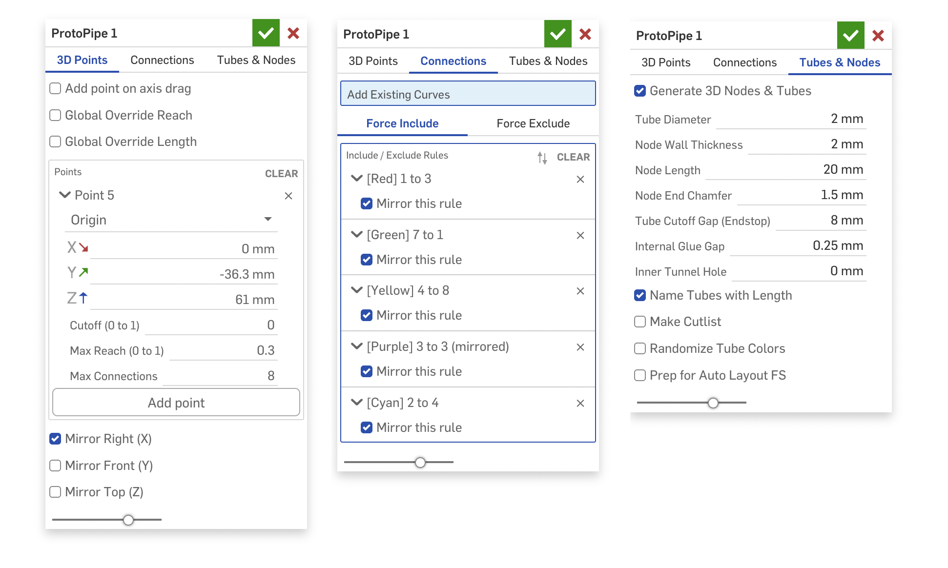

I wanted a tool that lets you drop 3D points on the fly, adjust their "Reach" to control connectivity, and instantly generate a prototype-ready structure.
Enter ProtoPipe! A fast way to design spaceframes that are easy to fabricate.
The tool is split into three simple tabs that guide you through the workflow:
  • 3D-Points: Add and tweak your points, then set the "Reach." A Reach of 0 connects only to the nearest neighbor, while a 1 connects the point to everything in sight.
  • Connections: Manually include or exclude specific lines if the automatic Reach settings need a little fine-tuning.
  • Tubes and Nodes: Generate the final 3D geometry. And It preps the tubes so you can easily auto-layout them for fabrication later.

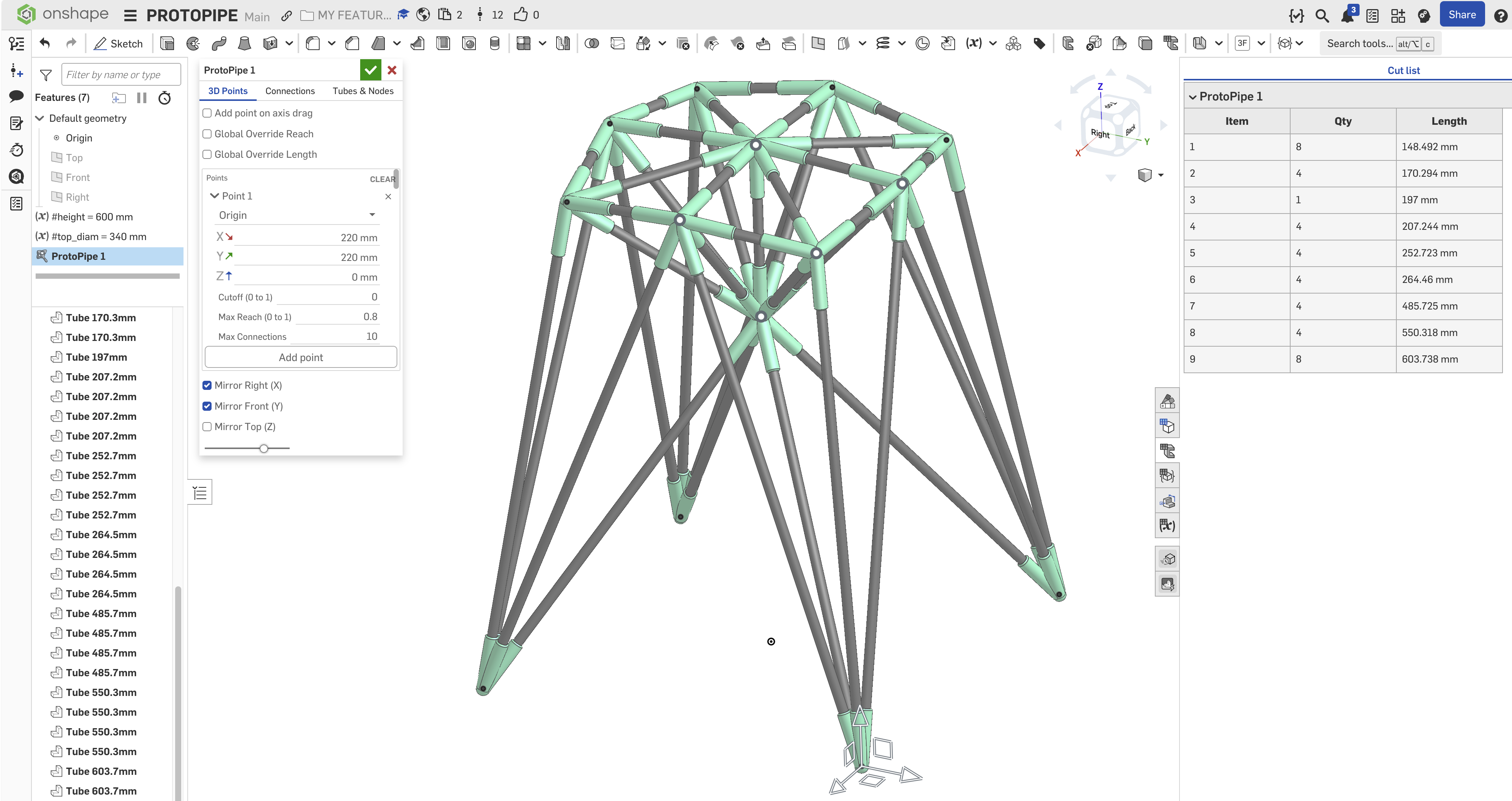

  • roman_jurt190roman_jurt190 Member Posts: 88 EDU
    I did some real-life tests. I designed a laptop stand in 5 minutes, printed the nodes (in PA12 on your Fuse 1 printer). and cut and assembled the 2 mm stainless steel wires on the fly, using the digital model as a guide. This took me another 5 minutes.
    I'm really happy with how quickly I could iterate through different ideas and node placements. The resulting structure is rigid while remaining lightweight and elegant.
    I suggest unchecking "Generate 3D Nodes and Tubes" until you're satisfied with the construction, and only enabling it at the end.
    OK! New version – the point-selection UI is now the same as the routing curve. It feels quick and very intuitive. I like it a lot. I also added a cutoff value (where the shortest connections get cut off).
    There are quite a few improvements in the connections tab as well. You can toggle between include or exclude, and when you click two points, a new line gets generated or an existing line disappears. I couldn't get the classic selection box to work (apparently, it's impossible for a Query selection box to resolve to entities created by the active feature itself during the editing phase), but my workaround with colored lines and selected dots turning green works well too.
    I also implemented a cutlist, an option to name the parts with their length, and some other smaller things and tooltips :)
    I tested it, and I really like the interactions that let you iterate and try different layouts in seconds! And when assembling, selecting a tube highlights the tube length in the parts list – quite comfortable.

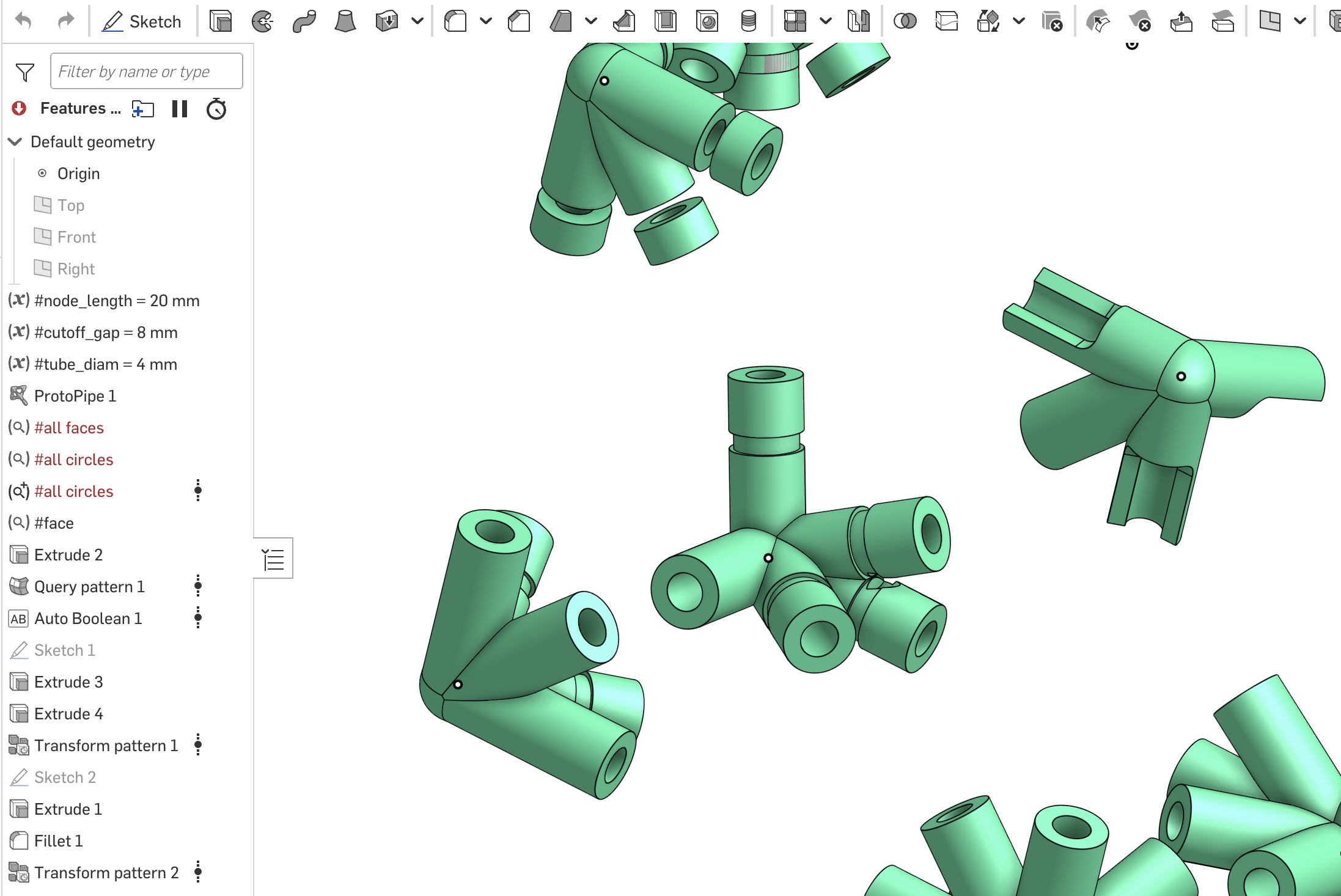

    edited July 15
    @EvanReese Thank you! Adding some helpers to a later process would probably be a good thing... I tried to subtract retaining rings and clips onto each node... but couldn't even get a query variable to work with the nodes (I tried matching, circle, arc, surface...). They are geometrically all the same, in wild orientations... but the same. And query pattern was not very helpful therefore either :)...
    Here are my tests - if a query expert would like to try :)
