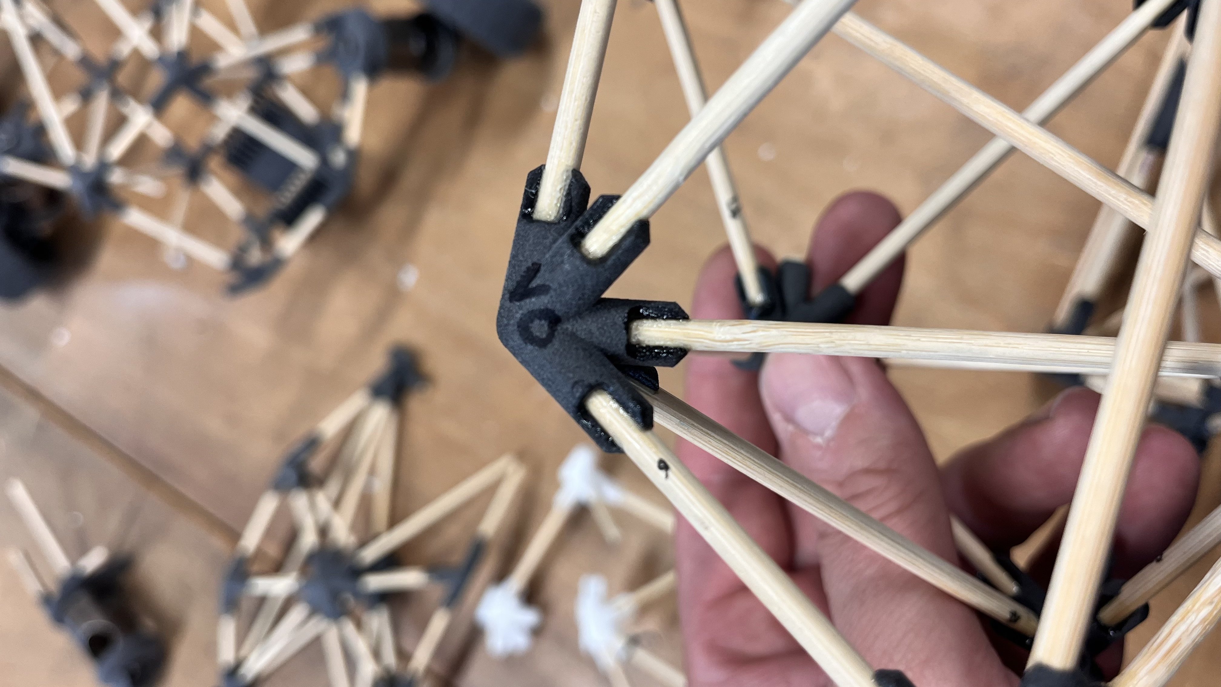

Dear PiedPipers!
Link to the ProtoPipe
Every year, I challenge my Industrial Design students to an "intuitive engineering" contest: building bridges out of wooden sticks and 3D-printed nodes. Building these the standard way – juggling 3D-points, routing curves, queries, and pipe edges – works okay, but means a lot of going back and forth…
I wanted a tool that lets you drop 3D points on the fly, adjust their "Reach" to control connectivity, and instantly generate a prototype-ready structure.
Enter ProtoPipe! A fast way to design spaceframes that are easy to fabricate.
The tool is split into three simple tabs that guide you through the workflow:
  • 3D-Points: Add and tweak your points, then set the "Reach." A Reach of 0 connects only to the nearest neighbor, while a 1 connects the point to everything in sight.
  • Connections: Manually include or exclude specific lines if the automatic Reach settings need a little fine-tuning.
  • Tubes and Nodes: Generate the final 3D geometry. And It preps the tubes so you can easily auto-layout them for fabrication later.
I'm not entirely sure if there is a massive real-world use case for this yet, so I’d love to hear what you all think. And maybe this is a case where a classic custom feature tree still makes more sense:)
But here are a few ideas to get you started
  • Go big: Build structures way larger than your printer's build volume using standard PVC pipes.
  • Scavenger prototyping: Use drinking straws, dry spaghetti, broomsticks, cardboard tubes, pool noodles selfiesticks….
  • Print flexibility: We use SLS printers (which are perfect for the complex nodes), but standard FDM works perfectly fine too.
  • Get flexible: inflatable bike tubes could create dynamic, flexible frames.
  • Snap-fit Assembly: In an older Part Studio, I had partly open nodes working so you could snap the tubes in from the side – no sliding required!
    Bringing that back would mean changing the whole architecture, though...

  • roman_jurt190
    roman_jurt190 Member Posts: 89 EDU
    I did some real-life tests. I designed a laptop stand in 5 minutes, printed the nodes (in PA12 on your Fuse 1 printer). and cut and assembled the 2 mm stainless steel wires on the fly, using the digital model as a guide. This took me another 5 minutes.
    I'm really happy with how quickly I could iterate through different ideas and node placements. The resulting structure is rigid while remaining lightweight and elegant.
    I suggest unchecking "Generate 3D Nodes and Tubes" until you're satisfied with the construction, and only enabling it at the end.
