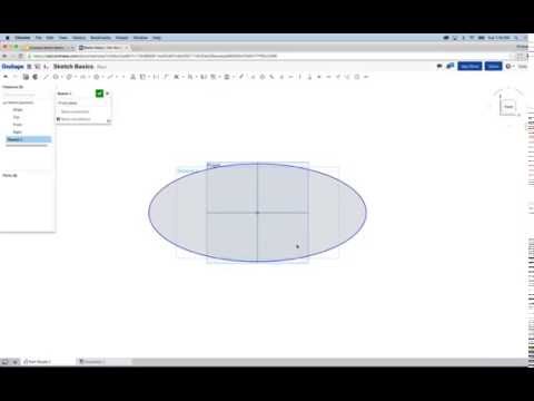

    and sketch specific here: https://www.youtube.com/watch?v=P3aYR9HCS6I

    Thank you, [for making this info available]; this video presents useful info, however; having already seen THIS;  what I need involves the next basic step.
    Drw 2 Cirs...connect perim.w/Lns ?? ... make Lns TAN to Cirs. > [should form Face ??]
    I get nothing  ?
  • NeilCookeNeilCooke Moderator, Onshape Employees Posts: 5,901 image
    Can you please use "licecap" program (or other GIF image making software) to record your issue and post it here - sounds to me like you possibly have your circles in one sketch and lines in another - all entities must be in the same sketch and coincident with each other to create a shaded face in a sketch.
