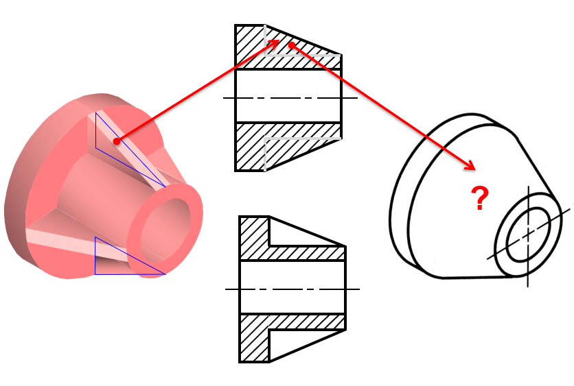

Hi experts
I created a rib and sectioned it. As per sectioning rules, I expected the rib NOT to be crossed hatched. Unfortunately, I have a sectioned view with a cross hatched rib. Is there a way to NOT have the rib cross hatched?
Thank you

  • alnisalnis Member, Developers Posts: 453 EDU
    edited April 2021

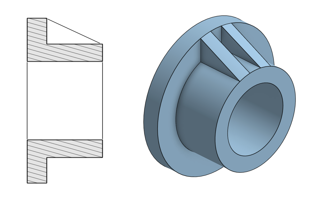

    For thin features, such as ribs, flanges, etc., the standard/traditional convention is to draw an outline without section lines to clarify that it is a different thickness (or, for some cases, to use different hatching rather than no hatching) while still sectioning the geometry. This is governed by ASME Y14.3 4.2.1 [EDIT: looks like the numbering changes between versions; it may also be filed under 10.3.1].
    However, it is also allowable to use a "true geometry" representation without different hatching (what currently happens in Onshape). I believe SolidWorks allows you to choose whether you want to use a "conventional" or "true geometry" representation when sectioning thin features.
    Here is an example where the thin features are sectioned without hatching:
    Here is one where the section has different hatching:
    Ultimately, I don't think it makes it too much more difficult to understand the drawing if we can't apply different/no hatching to thin features, but I also know some organizations are very particular in the conventions they would like drawings to follow.

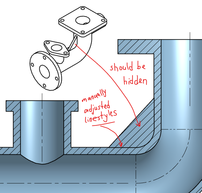

  • seyozenseyozen Member Posts: 9 EDU
    An update to help you understand how this missing feature causes a problem
    edited December 2025
    In reality, if there is a mechanical load that requires the use of a double rib, engineers will simply choose to thicken a single rib for both manufacturing and mechanical optimization. :)
    However, if we have a part like the clever example you gave, the cross-section will not look as you described. We need to show it with hidden lines, as shown below.
    There is a real need for this hatch (rib) exclusion feature because editing technical drawings with AutoCAD to comply with ISO and ASME rules creates data that is disconnected from the solid model. Thanks for your time.

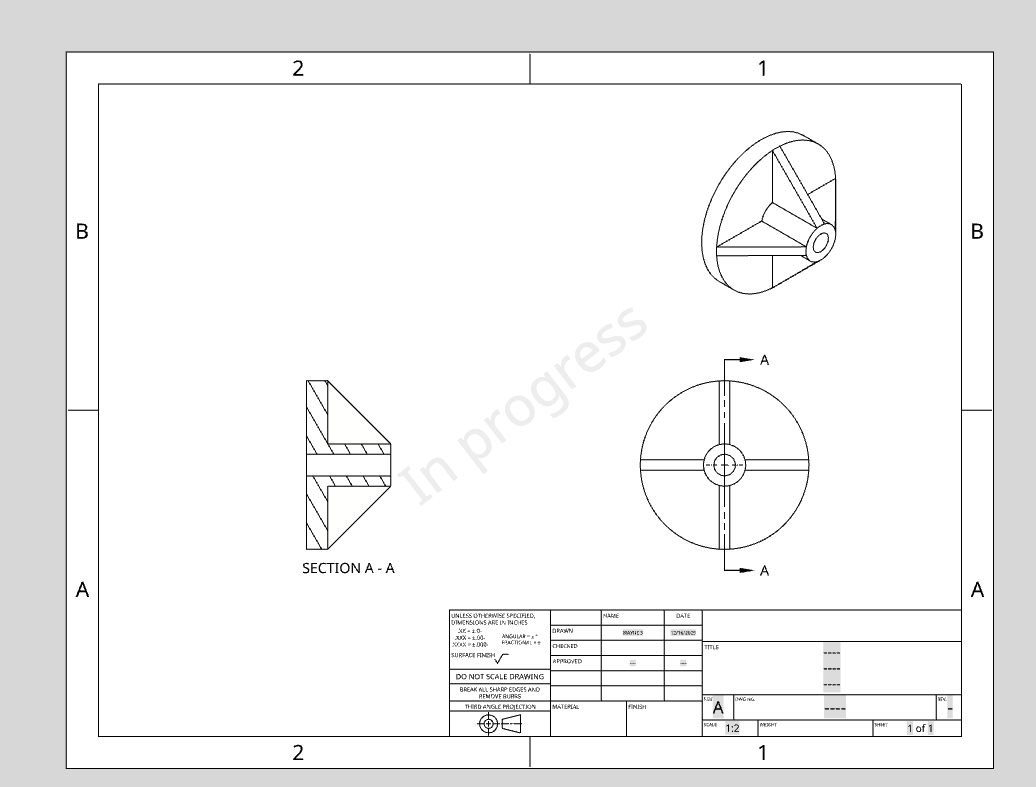

  • wayne_sauderwayne_sauder Member, csevp Posts: 669 PRO
    No need to go to AutoCAD. Do it manually in the drawing. Still disconnected from the CAD data

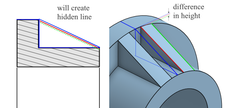

    Edit: Yep I can create this rib as unmerged and I can hide the hatch. But this makes 3D models a little complicated as two bodies. For future operations such as FEM, CNC etc. this multiple body sulutions become problematic.
  • NeilCookeNeilCooke Moderator, Onshape Employees Posts: 6,078 image
    You are right. In SolidWorks, all it does is suppress the rib feature from the model, create the view, then unsuppress, which is why it is pretty much useless. IMO, all we need is the ability to hatch an area of a shown sketch. I think it is unreasonable to expect a 3D model to understand what is a thin feature for drafting purposes and it should be on the designer to define that.
    Here is an example of a shown sketch, plus manually added geometry (which can be hatched).
