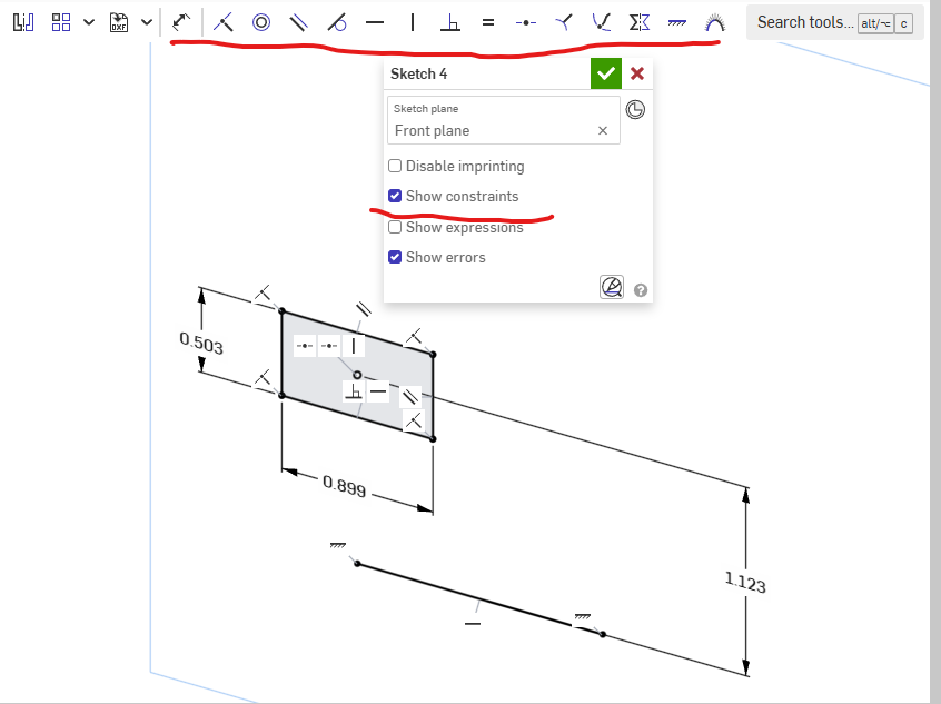

There is no right click constrain. Constrains including dimensions are across the top tool bar. When all turns black the sketch is fully constrained. You may want to take some of the learning center courses regarding sketching. Well worth the time.

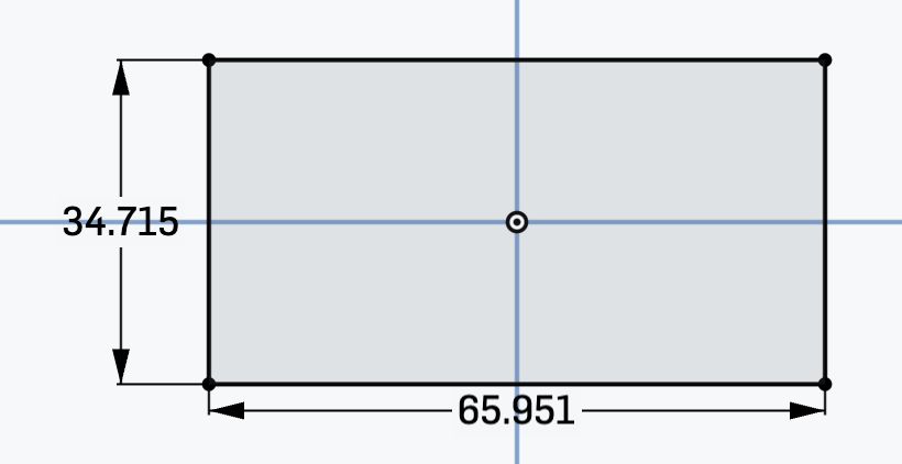

Re: How can this not be defined?
Hey Michael. If you click and hold on a line of your rectangle and move your mouse around, you can move the rectangle around. This is why it is not fully defined. The rectangle has to be fixed someplace; it has to have a 'fixed' location. Since, as it is, there is nothing else in your sketch, the only point to reference the rectangle to is the origin but that's fine.
Select any corner point and the origin and select the Coincident constraint or create dimensions from the rectangle to the origin. Everything in a sketch has to be 'fixed' either by constraints or dimensions. This doesn't mean you must always constrain a sketch entity to the origin. You can constrain a sketch entity to a previously created entity (a circle for example) but the place of reference on that that previously entity must be fully constrained for that to work.
- Scotty

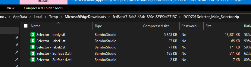

Re: Is there a way to customize part names within an exported zip file?
3 years later part export rule is ignored in part studio/assembly export:
The result:
