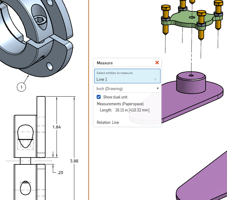

Re: Improvements to Onshape - January 9th, 2026
I just noticed there is Measure command in drawings… and it has Dual Units!!
When can we get dual units in the Assemblies and Part Studios???

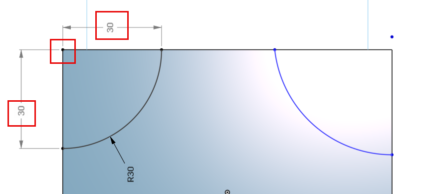

Re: Remove over extrusion from sweep that extends past face on another part
@Martin_29 The center of the arc needs to be at the vertex of the square. Like this. The sketch on the right shows the center of the arc is slightly above and will cause the sweep to come in at that angle. That is why your sweep is not working.
Here is the document for reference https://cad.onshape.com/documents/40b95184acc45ffc4546befa/w/0ff2ed48542ada6efa509cf6/e/6f01d7e2f78c9df4f40a52d0

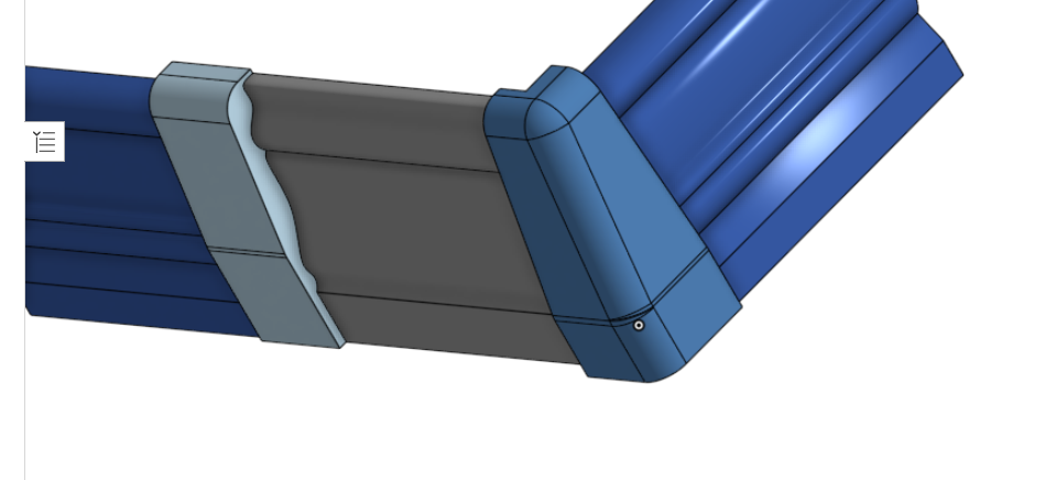

Re: Can you add a point/vertex to an existing sketch? (Trying to fix a twisting loft)
Yes, of course. Something like this to blend better.
