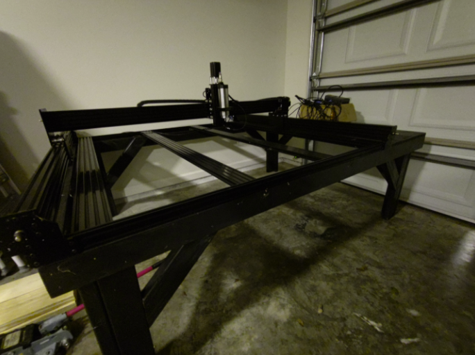

Looking forward to testing out CAM Studio again with all these improvements. Finally finished the base for my WorkBee!

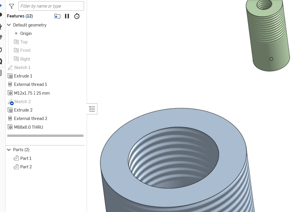

Re: Schematic Internal Threads
I see what's happening. The hole tool thread selection ends at 68-2.
There are some feature scrips that allow more options but you'll have to do a search through the previous posts. If you are unable to find then add your vote to previous enhancements requests.
