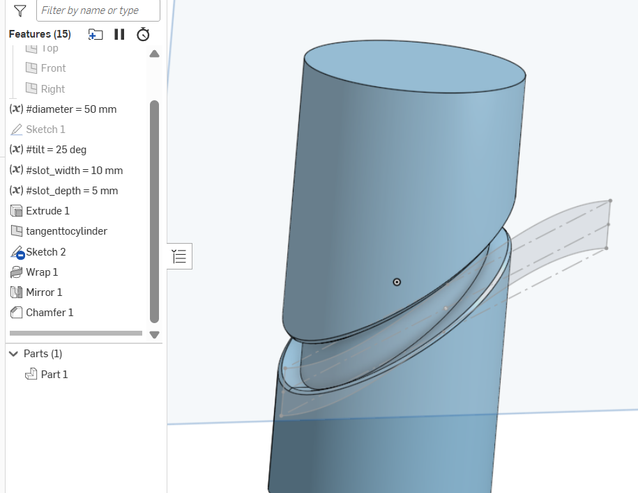

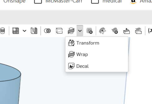

  • glen_dewsburyglen_dewsbury Member Posts: 1,322 PRO
    edited May 16
    @buk_browseruk
    There is a lot of back and forth here about mate connectors and angled planes to produce your sketch. You most certainly want to learn how those work since they will save a bunch of time for all work in OS.
    In the mean time the 'WRAP" feature will will get you there much quicker for a slot like this.
    Ps. Half wrap and mirror because OS has a problem if you go 360deg. Produces a non manifold condition or the like.
    https://cad.onshape.com/documents/ec9994607320087db3682d12/w/187cdb6ffb9d97c20a33dacf/e/99e818eef3ebeb13e7411e50

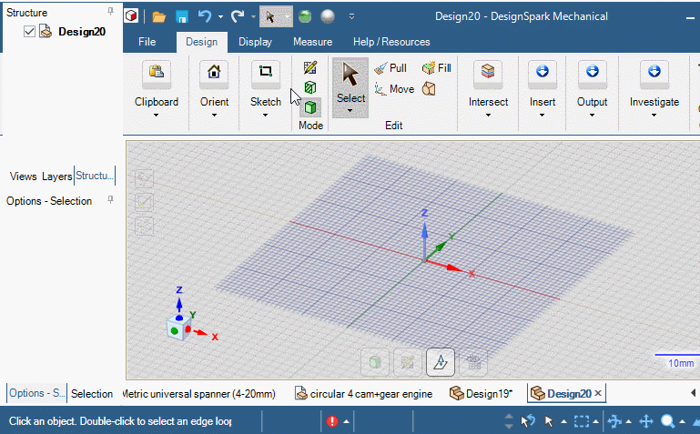

  • buk_browserukbuk_browseruk Member Posts: 14
    One last attempt to get some help with this. Here's how I do this is my CAD. (According to the gif recorder, this sequence took 2.15 minutes before compression!)
    Could one of you kind gentlemen produce a similar gif/video of you doing this using OS?
    Also, if there is a text based help system, could someone please point me at it? Cos I have not found it.
  • ry_gbry_gb Member, csevp, pcbaevp Posts: 200 PRO
    edited 3:08AM
    This is where the breakdown is happening. Design Spark is a direct modeling tool, whereas Onshape is a parametric-based program. Think of it more like Fusion 360 or SolidWorks vs Design Spark seems more like Rhino or Sketchup. If you've never used parametric CAD programs, then it would make sense that you're not used to it.
    I have my obvious biases, but I'm not gonna tell you which one is better or worse. You just need to get over the initial growing pains of learning a new CAD tool.
    That said, this is what I actually used to learn Onshape, coming from 10+ years of Inventor Fusion and SolidWorks combined. It's a K-12 learning set of written tutorials with GIFs.
    https://learn.onshape.com/learning-paths/intro-to-cad
    Ramon Yip | glassboard.com

  • wayne_sauderwayne_sauder Member, csevp Posts: 658 PRO
    @buk_browseruk
    No CAD system is perfect, and in each CAD, users develop workarounds.
    If I am following your design intent, I think this method gets there.
    https://cad.onshape.com/documents/a7d16049bf0952557f32b42f/w/05580a6f0e4926953456a2bd/e/565dc27390643495b62e8192?renderMode=0&uiState=6a0b3708524d70d07f2f620d
