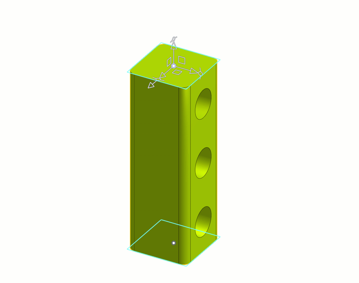

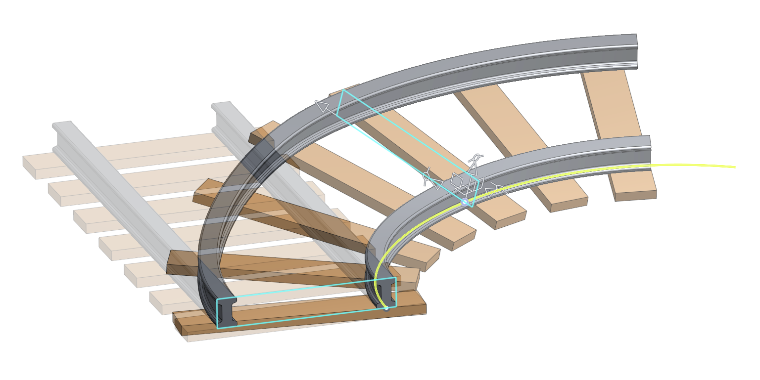

Deform (New Custom Feature!) 🆕
CADSharp & RENDERCAD have sponsored a new custom feature:
Deform
It deforms a parts and surfaces via profile sections or lattice grids along a path. Useful when you need to bend, twist, and scale parts after they have already been modeled.
Note: It is still a work in progress but I think its good enough for first release.
https://cad.onshape.com/documents/303775db976a02780499bec3/w/80a914faf16b9cdbd2f23…
Special thanks to:
- @Derek_Van_Allen_BD for laying the b-spline surfacing groundwork with Tween Surfaces.
- @vesa_timonen for laying the general geometry groundwork with Flex
- @EvanReese for laying the manipulator groundwork with Freeform Spline
- And last but not least thanks to GPT 5.5 for writing this entire feature; for those who couldnt tell via the 5000 lines of code… 🤣

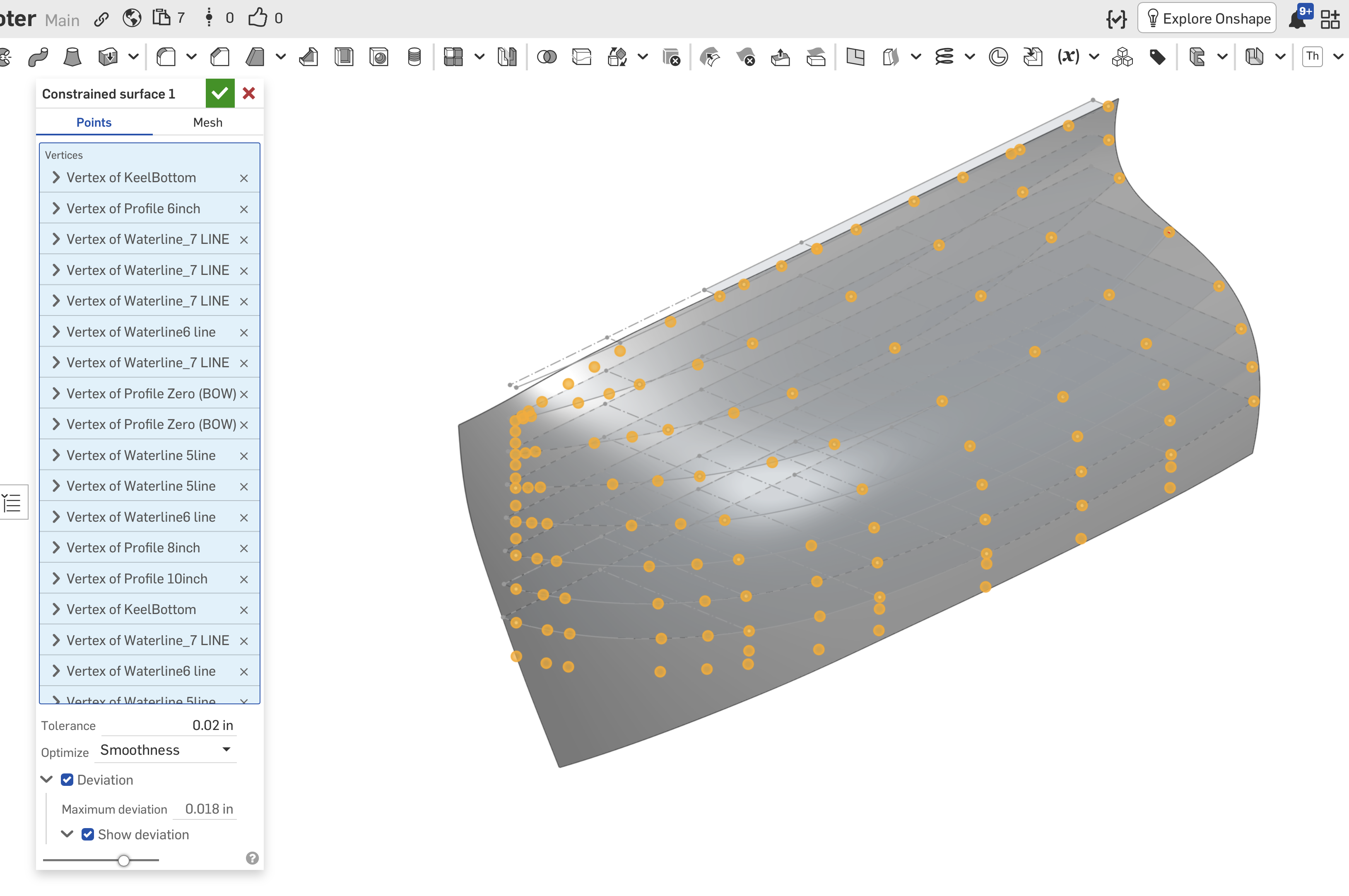

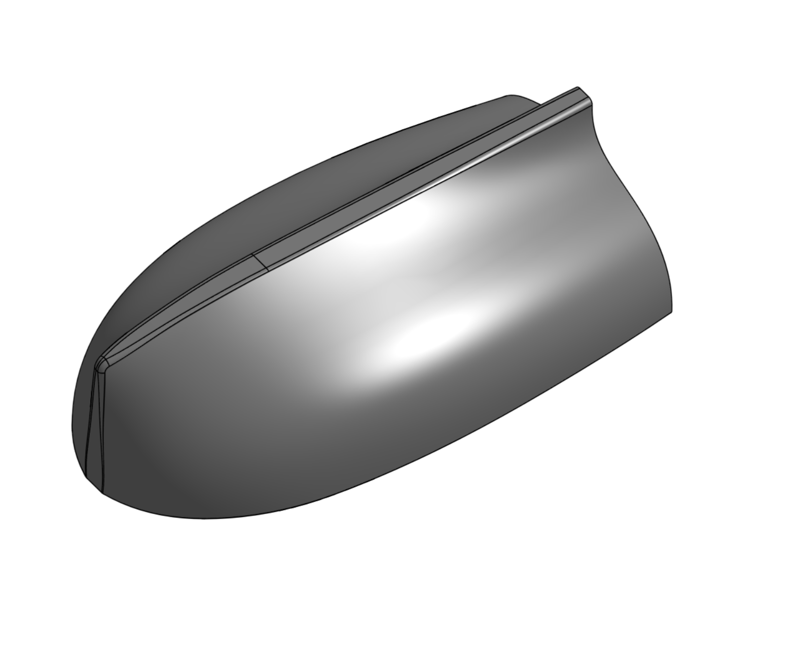

Three years later, armed with a lot more Onshape experience, and now the constrained surface feature, I revisited this little project and have solved my surfacing problem. It may or may not be a correct use of the tool, but by increasing the number of constraint points in the tight areas, I managed a perfectly adequate result.
Note that most of my issues (I think) arose from attempting to remain true to the original measured drawing, rather than smoothing its descrepancies.
Thank you all!
