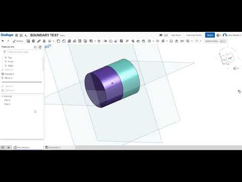

Thought it was user error but when mirroring a new part the appearance stays the same as if it were 'added' instead of 'new'. Changing the appearance of the original part changes both due to, I assume, the mirror operation.
Changing the appearance of the 'new' mirrored child part does indeed change the appearance but it's an added step and inconsistent with OS's normal 'new' part behavior where each new part has a different appearance attribute.
Thanks
http://www.youtube.com/watch?v=N2lt9IO2fdU
    Perhaps this is intentional behavior?
  • Konstantin_ShKonstantin_Sh Member Posts: 26 ✭✭
    I think this is because part patterning operations now also copy part properties and part appearence is one of them
    That seems to be true, but doesn't it also seem inconsistent with the way OS normally treats 'new' parts by giving them a new 'appearance'? I created a mirrored part in a multi part studio and noticed there were 2 parts the same color and I was confused and wondered if I had checked 'new' or 'add' but of course OS had mirrored both the part and the appearance. Seems inconsistent in its behavior but perhaps there are issues I'm not seeing and it is intended to behave this way?

    Hi.  If Onshape adhered to the colour cycle for mirrored parts I'd be writing an IR to exclude that behavior and take on the property of the seed part in the mirror, or at least have it as a checkbox option in the mirror feature! :)

    Ah yes, thanks Owen, was very curious about how others felt about the behavior and where one finds it inconsistent, others find it desirable, interesting. Do you not rely on 'appearance' to denote a different 'new' part in a studio? Perhaps I depend on that usual behavior too much?
    An option would be good but if others don't care then I'll learn to live with it as it's a pretty small issue.
    In this same multi part studio I mirrored all of the parts around a central plane and all of the 'new' parts retained their original colors which I didn't notice but was a really good thing. If they had all changed colors it would have made me crazy, perhaps making your point?
    Can't really see how to have it both ways...

    Hi Larry.  Thanks for bringing this up, it's always nice to bounce ideas around.  I'm not classically trained in good CAD practices so probably not worth  taking my preferences with much weight.
    a few thoughts in no particular order:-
    (a) Personally I don't rely on the colour of new parts at all. In fact I'll sometimes keep parts as one of the default colours so if parts cycle something might not shout "I'm new" if I happen to be actually using the colour deliberately for some parts. This raises the question of how about a setting that creates all new parts in some highlighted colour.  That way we can see at a glance anything that we've not yet saved properties for.
    (b) I find adjacent parts of the same material to be a visual problem.  It's hard to tell sometimes if we're looking at one part or many.  In this instance I tent to use the setcolor custom feature that @ilya_baran was kind enough to supply.  When coupled with a configuration with options "As Real World Colours" or "High Definition" colours that can make the design clearer.
