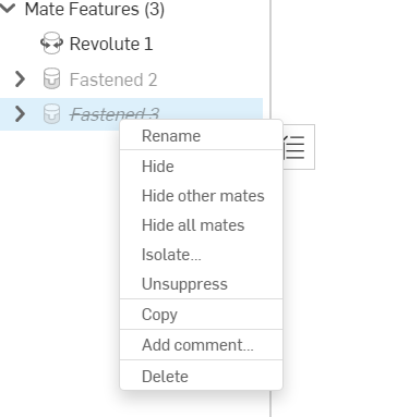

copy mate features possible?
rune_thorsen229
Member Posts: 182 EDU
No, you can't edit a suppressed feature/mate because you wouldn't be able to preview your edits.
I never noticed the copy option in the mates menu so had to try it out. Seems it is a reorder function - select mate(s) then copy, then right-click somewhere in mates list in the same assembly and "move copied mates here". I think it is a throwback from before we were able to drag and drop reorder mates. Should go really.Senior Director, Technical Services, EMEA5
I never noticed the copy option in the mates menu so had to try it out. Seems it is a reorder function - select mate(s) then copy, then right-click somewhere in mates list in the same assembly and "move copied mates here". I think it is a throwback from before we were able to drag and drop reorder mates. Should go really.Senior Director, Technical Services, EMEA5 -
The copy is not of any use.
(Well, it would be handy if the mating was temporarily disabled while editing until you accept or solve )NeilCooke said:No, you can't edit a suppressed feature/mate because you wouldn't be able to preview your edits.
