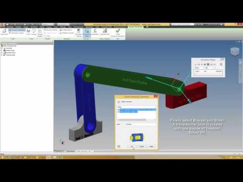

To be clear I'd like to have somethink like this in OneShape (or in Simascale or everywhere else in the web !!):
https://www.youtube.com/watch?v=RpacIMA4WM8
