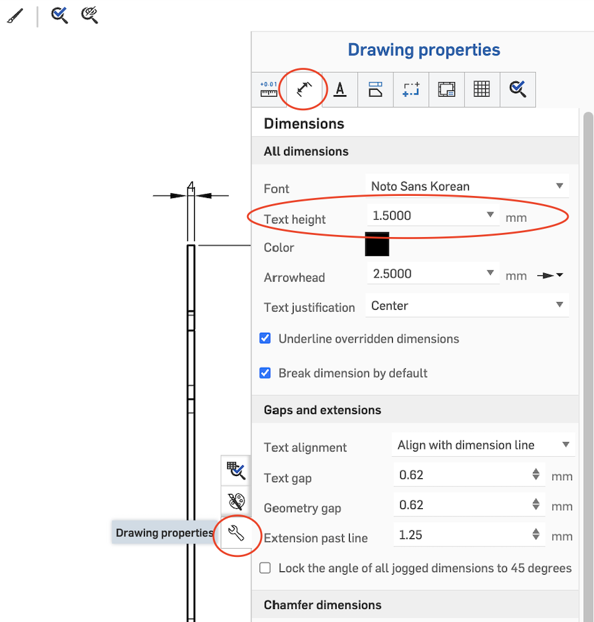

  • minkyu
    minkyu Member Posts: 2 EDU
    It's that simple 😀
    your welcome~
