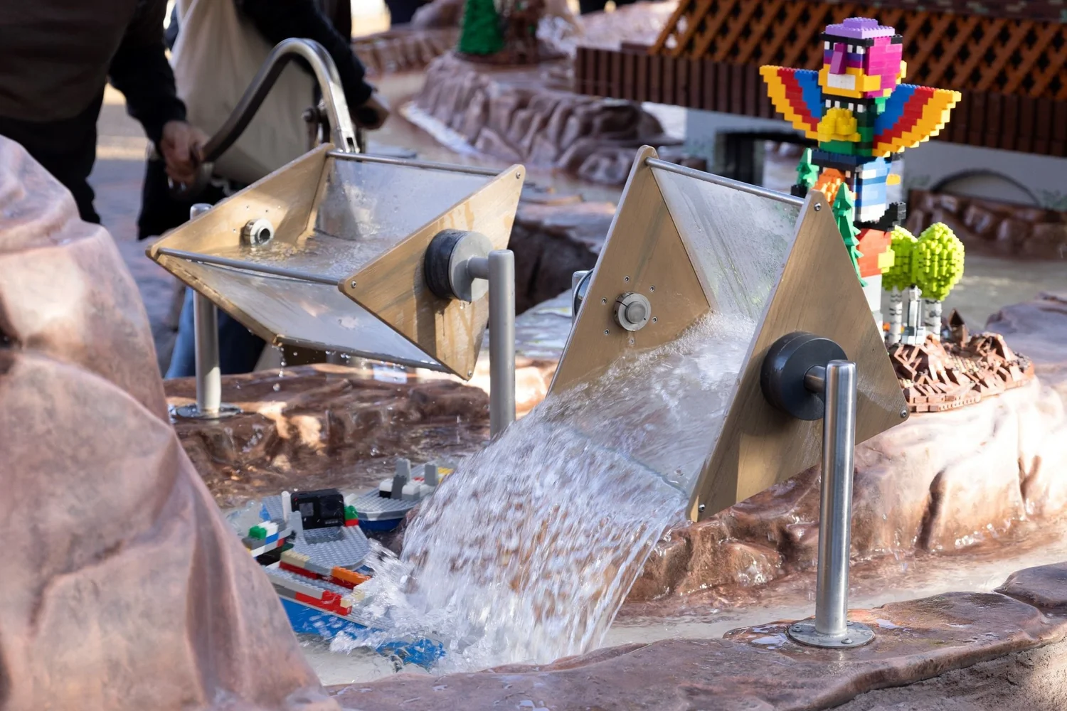

    I actually have a relevant example here. At Boss Display we produce a lot of tipping water buckets that need to fill up to a level that overbalances and dumps out the contents, then returns to neutral for the next filling cycle.
    Feathering the center of mass of all of the HDPE and Acrylic and Stainless Steel components that go into the bucket constructions in relation to the center of mass of the water that fills the assembly is critical to proper operation of these things and I've seen us do it without driving the geometry via mass properties and the result was always guess and checking with prototype parts. Sometimes you'd get a bucket that doesn't tip at all, sometimes you get a bucket that tips after a single pump of the bilge and the mechanism stays upside down instead of returning to neutral.
    So we're one of those cases where an anisotropic mass properties solver would come in handy for these builds, but I have yet to write the bucket solver script in featurescript.
