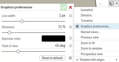

Good day Team,
Please see attached image for your reference.
Any way we can change how reflective a part is? Or better yet, make the appearance matt by default? The default look of the part is highly reflective and it is doing my head in..
I suspect another way of achieving this is to change the default part studio lighting options, how do we do that? Googling / looking under the help section didn't give me any helpful answers.
Thanks for the help guys.
Gordon

    Don't think you can change that. I like it as is because it helps with seeing curvature and smoothness of non flat surfaces. But an option to turn it off wouldn't be a bad thing. You could always work in unshaded mode if its that bothersome.

    This isn't currently a setting that can be changed, but you can click the little grey cube at the top right and change the view mode to unshaded. I suspect it will eventually be possible to represent materials better in the viewport though.

  • I found, that if you set "Specular color" to all black under Graphics Preferences… you get rid of the reflection.
    Can't be done for a single part, but will make every part unshiny.
