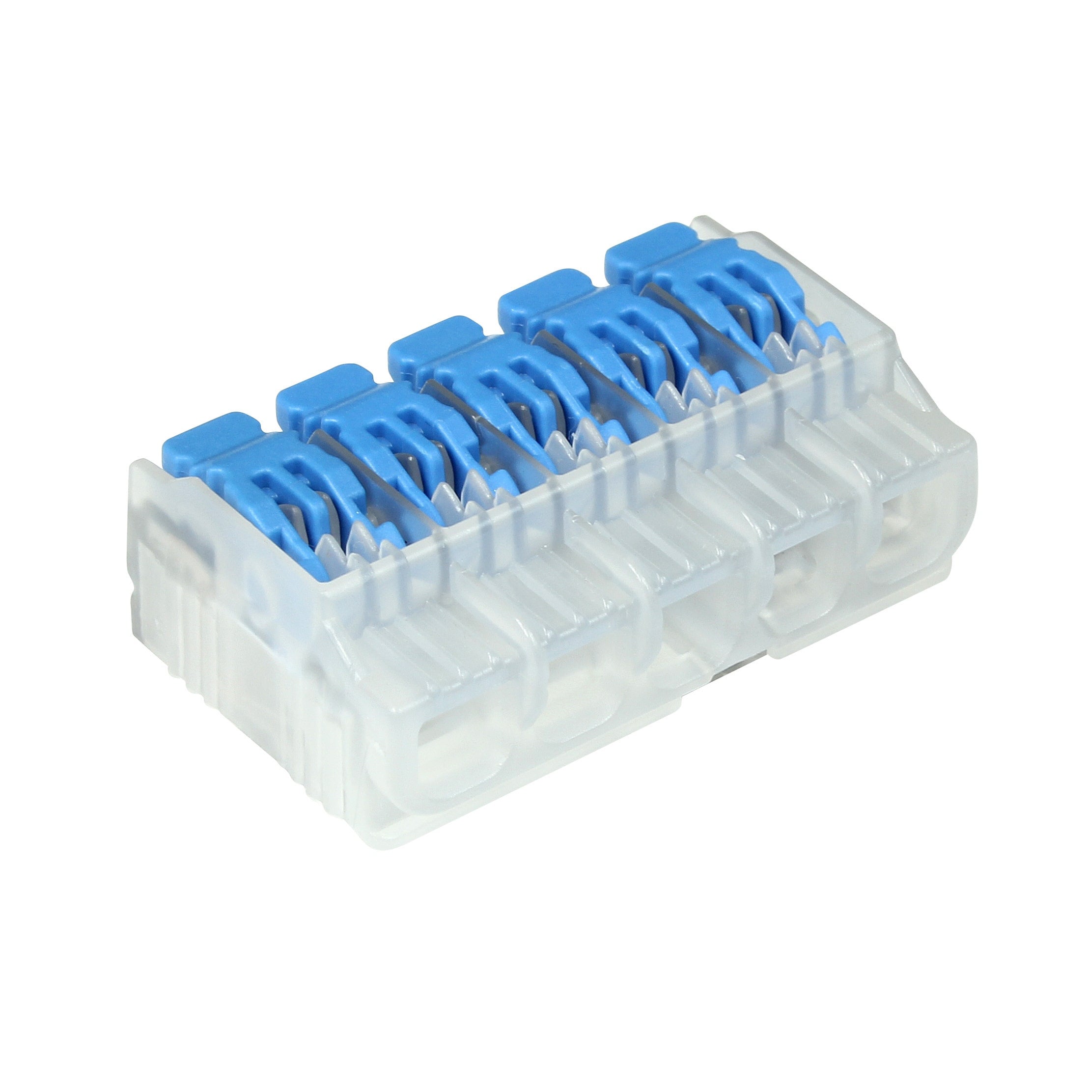

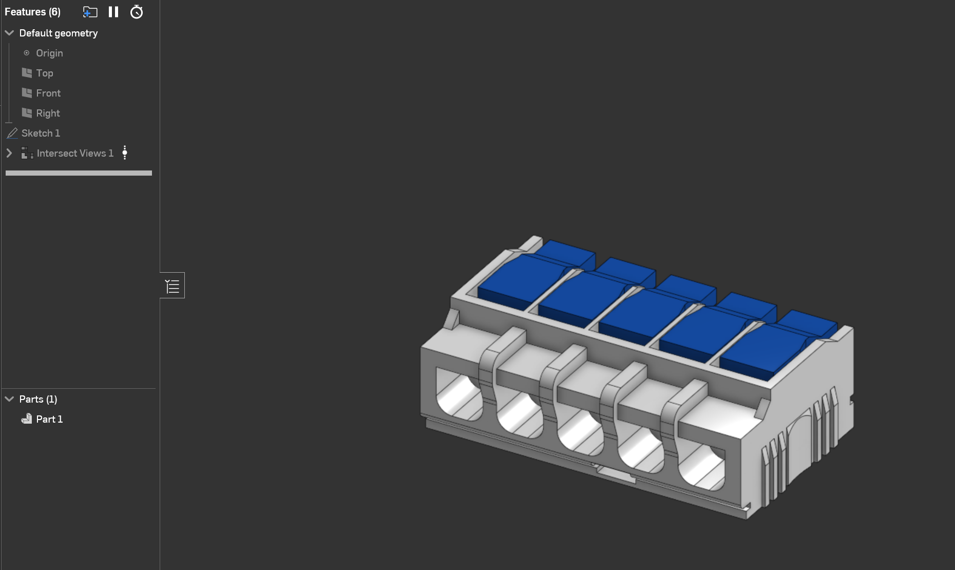

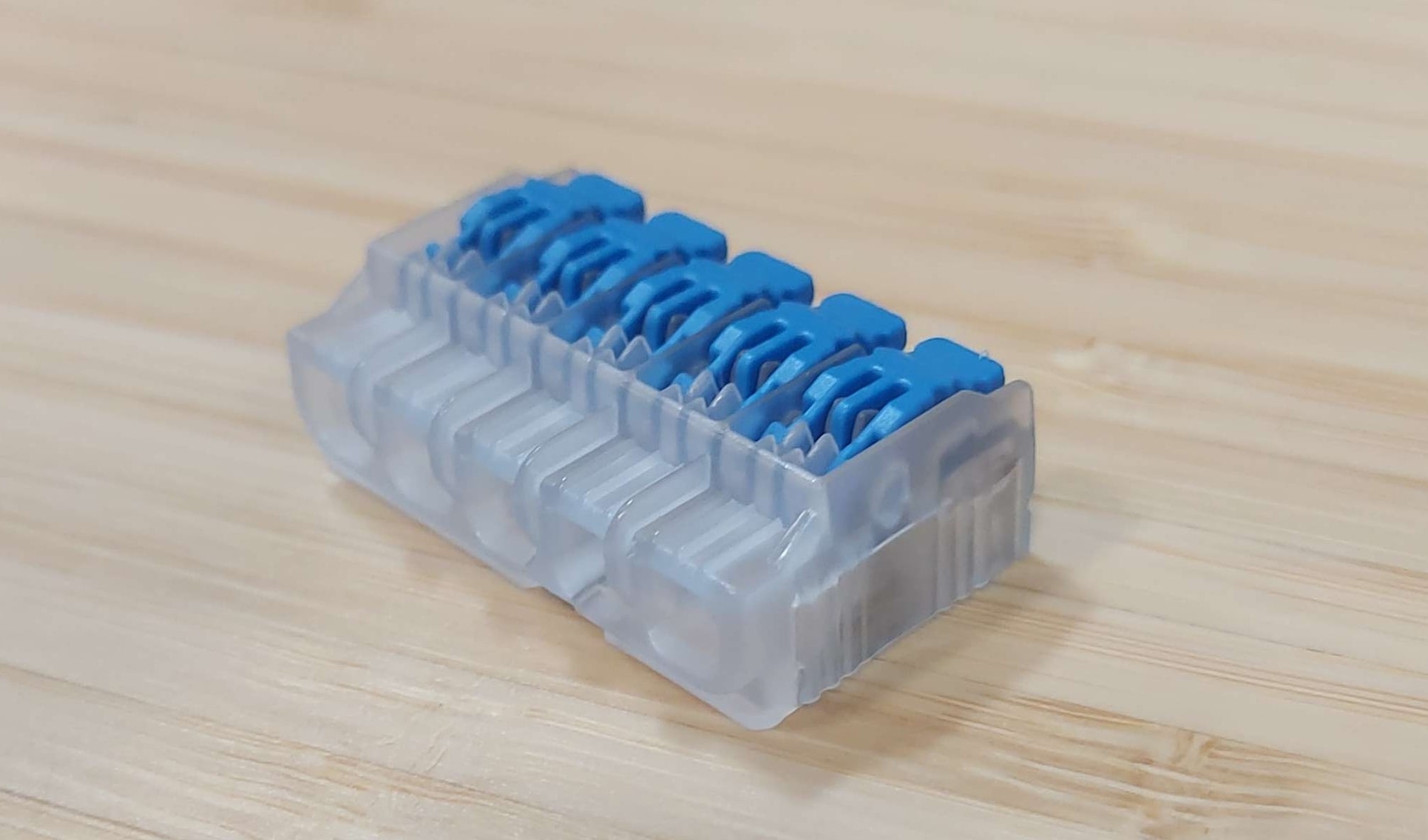

I made this using your featurescript. Thanks for making it, it's really cool.
3 -
Yesss!! took 6 years but someone finally used my feature 😆
That looks awesome @Evan_Sigl, nice work!.
