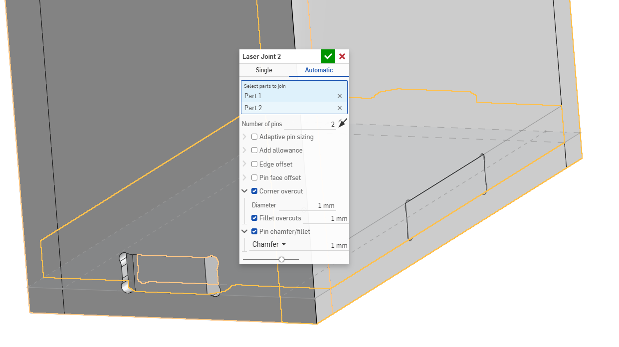

    Hi @lemon1324
    I´ve been using the laser joint for a long time but all of a sudden the chamfers/fillets stopped rendering on one side in all of my projects and I´m having issues connecting laser cut parts with tighter fit.
    In this example, the X axis is fine, but the Y is not. Settings are the same on both. Any idea whatś going on, please?
    Would you please also modify the max number of pins higher than 12, please?

  • lemon1324
    lemon1324 Member, Developers Posts: 230 EDU
    @stanislav_kucharčík sorry for the slow response, I've been busy with travel and work recently.
    I took a look at this specific issue and I think what's happening is that after the first joint the automatic mode for whatever subtle reason is flipping the "tab" and "base" parts for that joint so it's not the expected direction. And since the "tab" is the larger part, there aren't any true pins created for the chamfer to find and act upon.
    I'll take a more detailed look when I get a chance, but for now in any case where you want to specifically control the joint more tightly, I'd recommend using the "single" mode because you can more precisely control where exactly the pins are all going.
    Pin bounds shouldn't hurt anything to make it larger, I'll bump that up and push an update soon.
