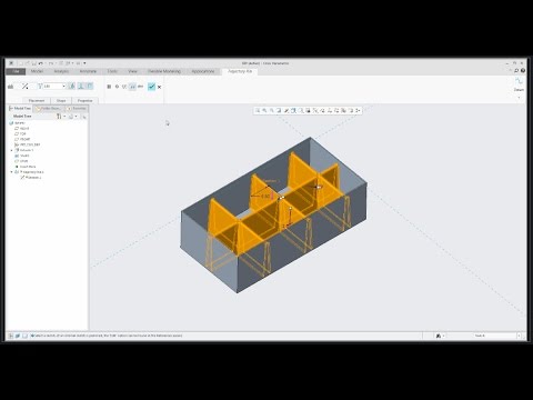

I'm trying to build a rib from a round edge but I can do it only when the line is not at the edge.
I understand that there is a problem with the round edge.
I'll appreciate if someone can give an idea to handle it
  • EvanReeseEvanReese Member, Mentor Posts: 2,695 PRO
    I think the issue is that if you put the rib right up to the edge the corners of the rib would hang over the edges. you could use an Extrude or Loft or Sweep perhaps if you want the edge of the rib to match the circle exactly.
  • romeograhamromeograham Member, csevp Posts: 731 PRO
    Another trick would be to use the Rib feature as you have done, and then use Replace Face (replace the face of the rib with the curved face of the part) or the Move face feature (to move the face of the Rib up to the curved face of the part).
    This allows you to still use the Rib feature.

      What we need is a so-called Profile rib. See this (Creo) video at minute 4:00 (https://www.youtube.com/watch?v=083RQmSn6mY&t=240s).In Onshape I have a workaround for that:
    1. Make the rib via Revolve.
    2. Replace the 2 flank faces of the rib with an offset from the sketch segment
    3. https://cad.onshape.com/documents/e51377d5946c9f26f8c4fc95/w/bb28cfc559312e726531793e/e/789f28aede42b11f568b66bd

    @bruce_williams - I was thinking that the revolved lower portion of the part had a face that could replace the upper face of the rib - you're right: it won't work with geometry like you're showing.
    I like @Henk_de_Vlaam's suggestion to use the sketch for an offset face replace operation on a revolved feature.
    @romeograham thank you. I agree @Henk_de_Vlaam’s work around is best or just live with rib being back from the edges a bit
    In this way I also split a complicated sketch in two or more sketches.
    For the sketch plane of the (second) sketch that must remain related to the first, I always choose a sketch segment from that first sketch.
