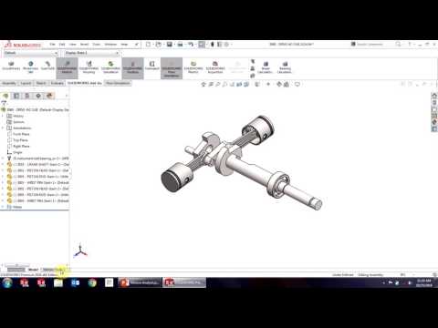

    To be more specific I like to know place of lifter in every 360 degrees of cam rotation. So I can get cam profile if I design a cam.
  • Lasse_5Lasse_5 Member Posts: 6 ✭✭
    In Solidworks you can plot motion. Very useful tool. https://www.youtube.com/watch?v=WoRA_Z1_pzU
