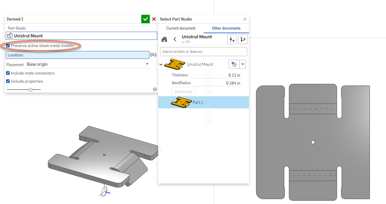

  • john_mcclaryjohn_mcclary Member, Developers Posts: 4,050 PRO
    edited October 2025
    They added "Preserve Active Sheetmetal" checkbox to derive a while back
    That should keep everything you need
    I use it for a "start part" for our sensor brackets that bolt to Unistrut.
    they all start with this, and I just add flanges to make the final part.
    In this example, it's configured so I can set the sheet-metal thickness and bend radius at the time of derive
    it even keeps properties and mate connectors as well
