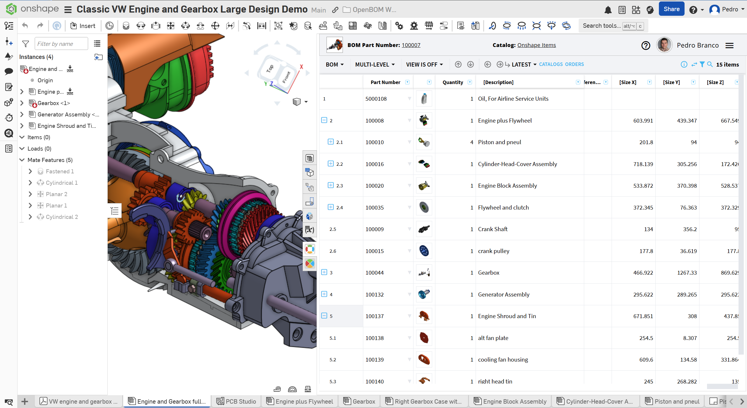

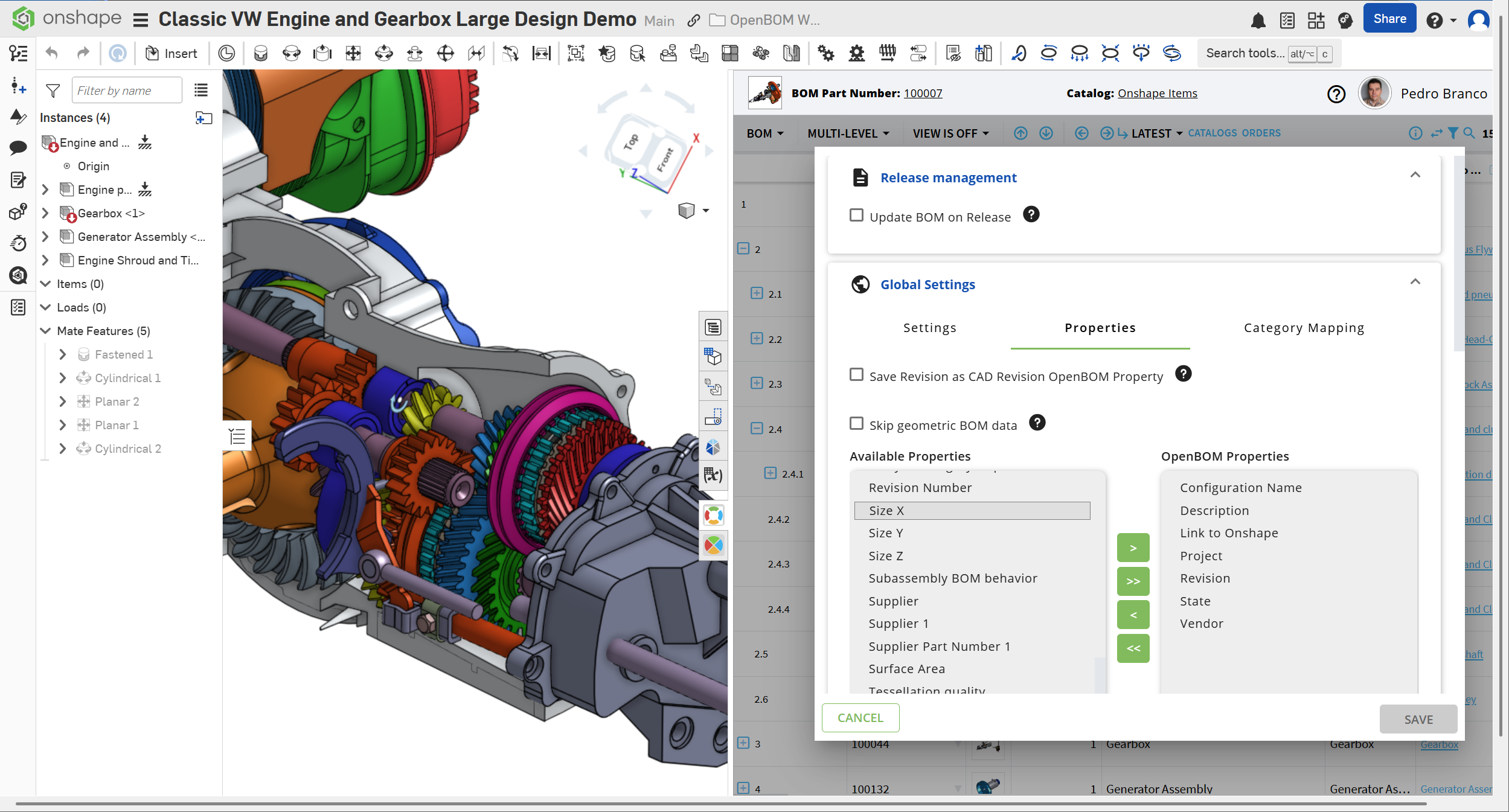

  • Pedro_Branco
    Pedro_Branco Member Posts: 2 ✭
    Hi @martin_kopplow
    OpenBOM can do this:
    Jus add the properties in OpenBOM addin settings
    More info in this video
    How to Integrate OpenBOM with Onshape – Full Setup Guide for Engineers
