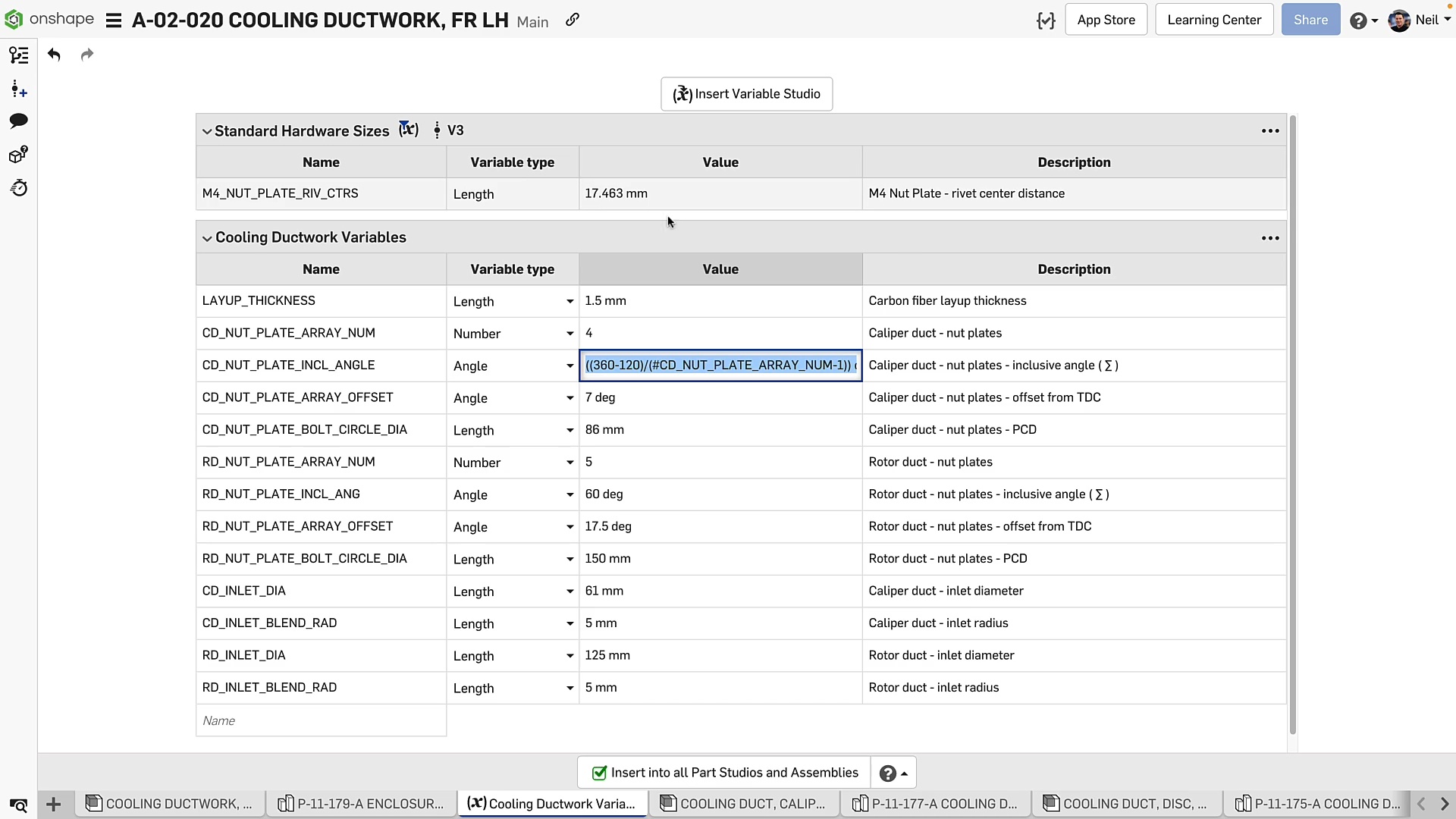

Any reason why you wouldn't just use Variable Studios now? You can take "notes" by using the description field.
https://cad.onshape.com/help/Content/variable_studio.htmImprovements to Onshape - June 27th, 2022 — Onshape
