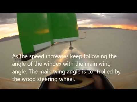

I've been designing , building and sailing solid wings on land and ice for the last 30 years. I always lofted the wings full scale on my work bench. I wanted to learn a better way to draw the parts. Now I can cut out the ribs using a cnc router because of Onshape. One of my old wing boats -
https://youtu.be/_4ds-poJ4PQ
