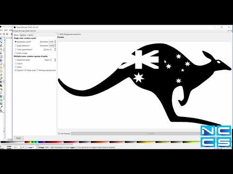

  • _Carbyne__Carbyne_ Member Posts: 17 EDU
    I got the DXF file by converting PNG to DXF using Inkscape (I followed this tutorial: https://www.youtube.com/watch?v=eBEN0Q0Pmlk) Is there a better way to convert images to DXF files to get splines and a higher resolution?
    The double lines must have been because I did not delete the duplicate image, as image trace produces a new copy right on top of the original image.
