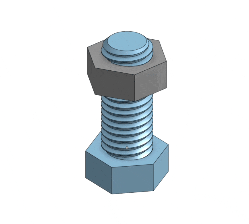

I would like to animate a simple assembly, but/bolt, using the free IOS version - is there a way to do this rather than manually rotating the nut?

    Super simple…. In the Assembly use a Cylinder Mate between the Bolt and the Nut, then just use a Screw relation on that mate..
