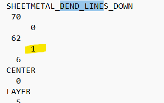

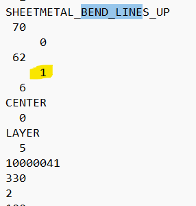

    Adding to @sebastianMaklary.
    To change the color of bend lines you need to search "bend_line" and then you will need to go to result as shown in the image ( only two instances, one instance of SHEETMETAL_BEND_LINES_UP and one instance of SHEETMETAL_BEND_LINES_DOWN ) and then change 4th line which has indented 7 to 1. (1 will give you red color. Again refer to this link for color code standard
      https://gohtx.com/acadcolors.php
    Save the file and then you are good to go.
    Open the saved .dxf file in laser cutting software and assign the layer of white lines to cutting and red lines to Mark.
