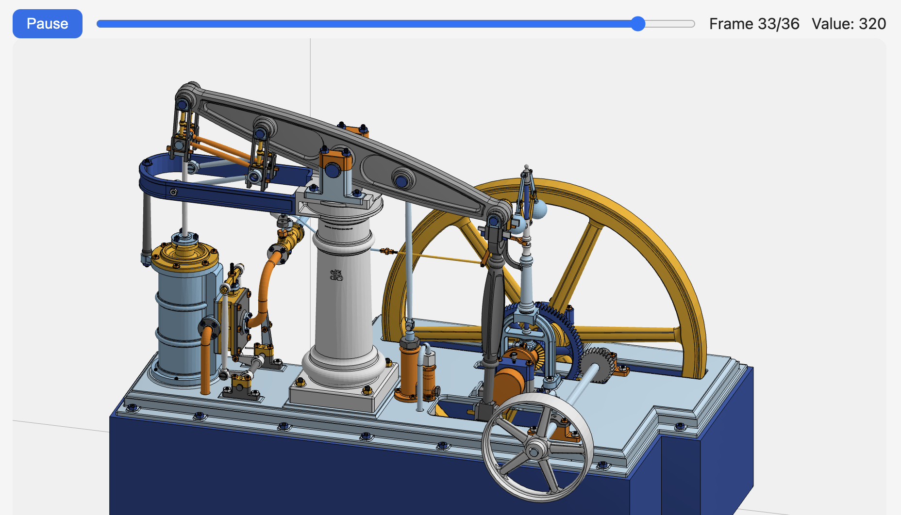

  • eca_elioaceca_elioac Member Posts: 17 ✭✭
    @christian_petty Hi, I think I've built something similar to what you're doing here…
    https://www.loom.com/share/a0fa188faead490ea10d43f20a12d888
  • christian_pettychristian_petty Member Posts: 84 PRO
    @eca_elioac that is slick! I've always been intrigued by single file HTML/JS for sharing data/tools.
    If the GLTFs are still too big, you could use fetch on the Onshape API to pull the triangles. It's probably trivial for public documents, but you'd have to handle credentials for private.
