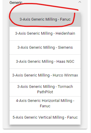

  • Gabriel_SteinGabriel_Stein Member, csevp Posts: 7
    Hi @bill_schnoebelen,
    Can you inform which machine/post you would need the ability to output in inch?
    Regards,
    Gabriel Stein
  • bill_schnoebelenbill_schnoebelen OS Professional, Developers, User Group Leader, csevp Posts: 130 PRO
    Generic Fanuc
    Machine is a Brother S700X1  with C-00 control.

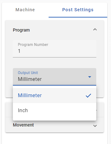

    The "3-axis Generic - Fanuc" will have a option in "Post Settings / Program" for "Output Units" - this will convert any linear dimension at NC generation, allowing for Inch output.
    This Fanuc post will have this from version 1.175 onward.
    Other posts will also soon have that ability.

    Does the 3axis Generic-Fanuc have this post setting for inches available? I see the current version for CAM is 1.175.671.213877
  • John_P_DesiletsJohn_P_Desilets Onshape Employees, csevp Posts: 261 image
    @BRYAN_MEZCO_CAM1 Yes, the output for unit type is available for 3axis generic-fanuc.
