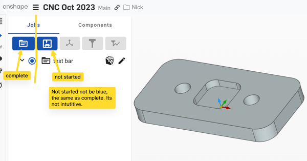

IMO, "not started" should be greyed out, not blue. Its not intuitive where you are supposed to be. That's counter to most every other UX.
    Yes.  This confused me as well in the exact way you described above. It's pointlessly confusing.  Poor UI choice. One of many things that need improving on the UI in my opinion.
    What it's doing is trying to show you what buttons are valid to use and what are not.  It won't let you use the tool path button until you have defined a tool.  It won't let you use the tool button until you first define a setup, etc. But after adding Job, the machine becomes valid, so that is why it's BLUE in the example above.  And JOB is still valid because you can add more Job features to the list as well.  Both buttons are currently valid to use, so both are enabled and blue.  I didn't figure this out until I started writing this reply.  That's how confusing it is. (I've been doing software development and UI design since the 70s, and I didn't even grasp the point of this until now -- which means I had to learn how the entire system worked before I could understand what it was trying to "help" me with.
    In my view, this has no valid purpose and should be removed to make the interface less confusing.  Part Studio doesn't highlight the Sketch button and disables all the other buttons, like extrude, that can't be used on a new empty studio.  It will let you open and look at the extruded dialog even though you have no geometry to select.  You can modify values and save it as a feature, even without the geometry.  The extrude feature is added to the list even though it's incomplete and turns red to show it's not broken.
    The CAM Studio should work the same way,  Allow people to click on any feature and don't force them to add a Job first.  This helps yu learn faster if the first thing you do is just start clocking on all the buttons to see what they do and what they are used for.  By disabling and blocking some features it only slows down the learning process and adds confusion for the beginner.
