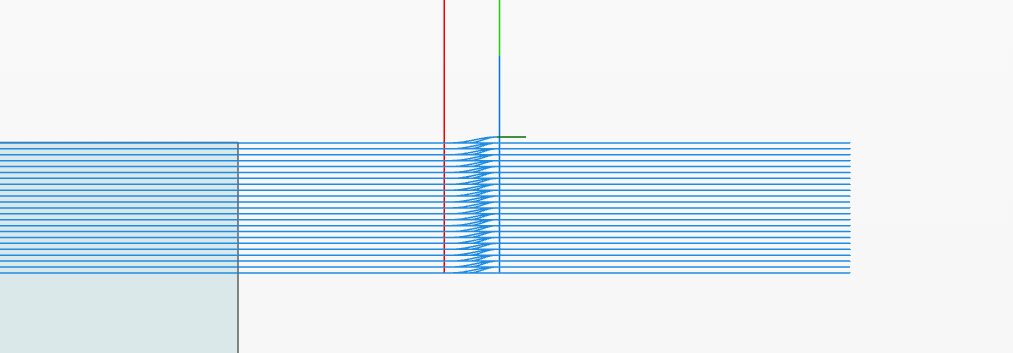

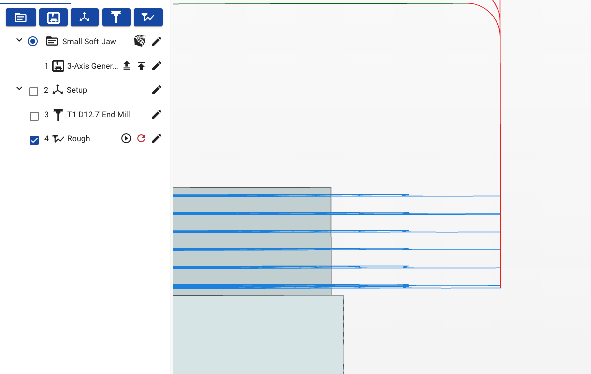

There seems to be something weird going on here. I am only cutting a 1/4 in (maybe that is confusing it). The number of slices shown on the tool path does not seem to correspond with what the program is set to. Maybe I am not understanding something?

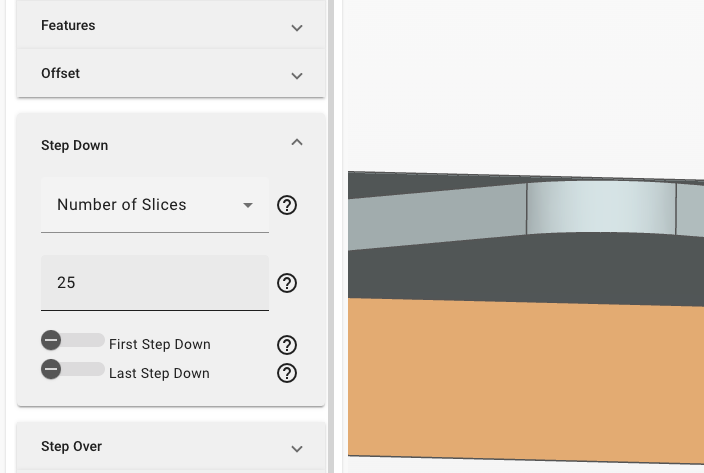

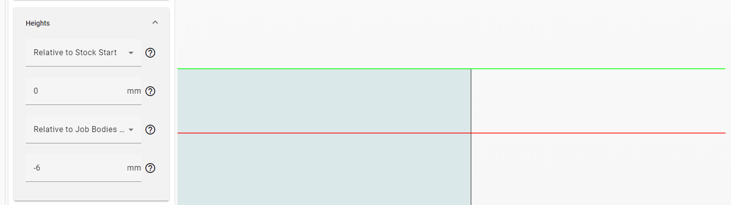

    @wayne_sauder  I am seeing a different result. I set the roughing to adaptive. Height is set to -6mm from the top of the part/stock. Step down set to 25 slices. Please feel free to submit a ticket on this if you continue to have issues.
    Heights
    Slices
