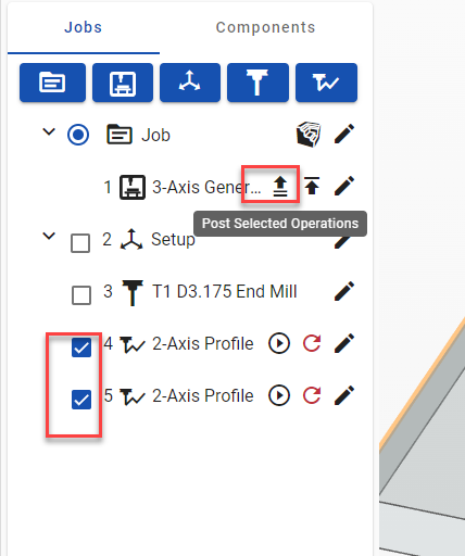

Hello,
Continued to use CAM Studio, do you know if there can reorder the operations from Process Tree and if yes, how ? And what should I do to select only certain setup/operation with its tool and tool path to post? Now the Post Child Operations button controls entirely job, but what if I need to post just partial operations or only one operation separate.
It looks like there is no such option on this release. Hope it will be added, it would be beneficial.
Thank you.
Sorin
  • John_P_DesiletsJohn_P_Desilets Onshape Employees, csevp Posts: 267 image
    @sorin_rotaru You can reorder by long clicking on the operation and dragging it to a different location in the tree.
    To post a single operation or a group of operations click the checkbox to view the toolpath. Next, click the icon "Post Selected operations."

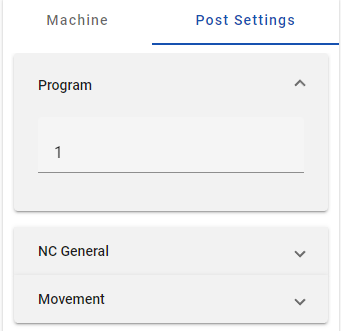

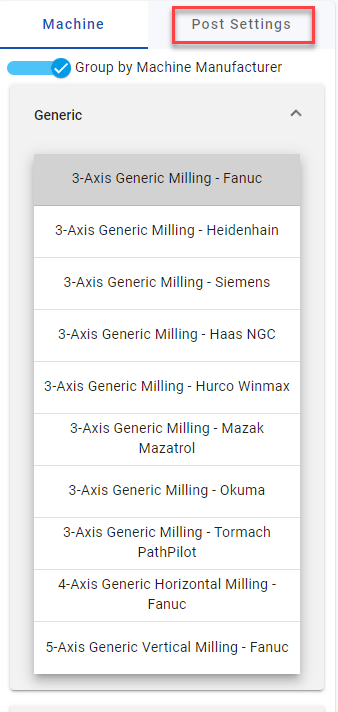

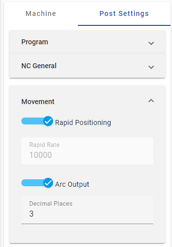

    @bill_schnoebelen To post a single file, you need to use the post child operations option. To edit additional post settings, edit the machine and switch over to post settings.
    here you can set the program name, enable block numbers and movement settings and enable or disable arc output.
    If are output is disabled, arcs will be X and Y movements only.

    Currently CAM Studio allows NC generation in two methods:
    1. You don't select any operations and then generate NC - this will generate one file, with all operations
    2. You select which operations you want to post - this will generate one file per selected operation.
