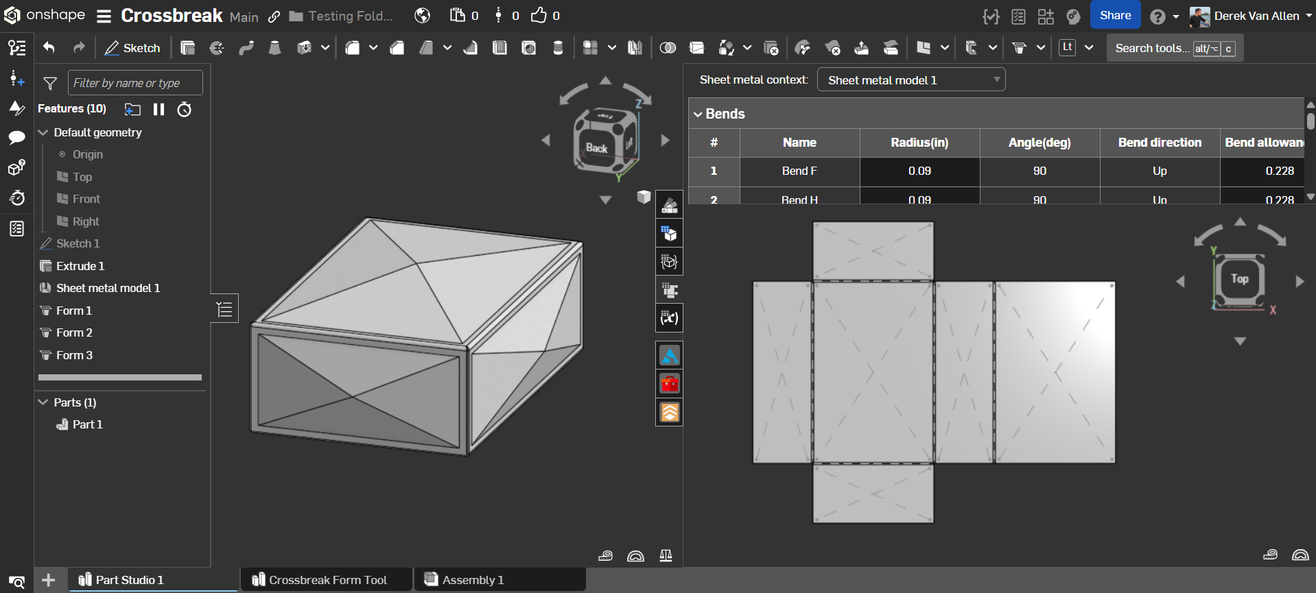

  • Derek_Van_Allen_BDDerek_Van_Allen_BD Member Posts: 423 PRO
    Shouldn't be a problem, cross break tools in other CAD systems seem to take a flat face and simply add sketch notation to the flat pattern without changing geometry, so this could work in a similar way but actually adding the former geometry to the 3d view. I'll cook something later today to show what I'm thinking.
    Here's a basic example of how you can make a form tool to do this kind of geometry without needing to make a custom featurescript. Note that you can't extend the form tool all the way to the edges of any of the panels because the sheet metal kernel will freak out.
    I could have made the geometry fancier with fillets for the sheet metal or made the dimensioning be done via angle callout but I'll leave those improvements as an exercise for the reader.
