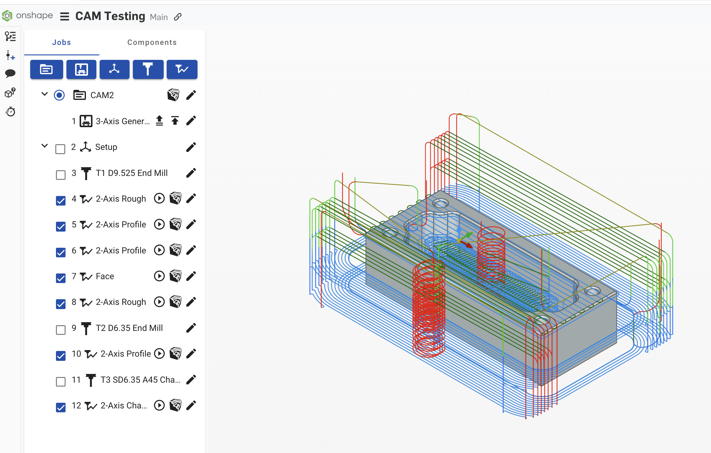

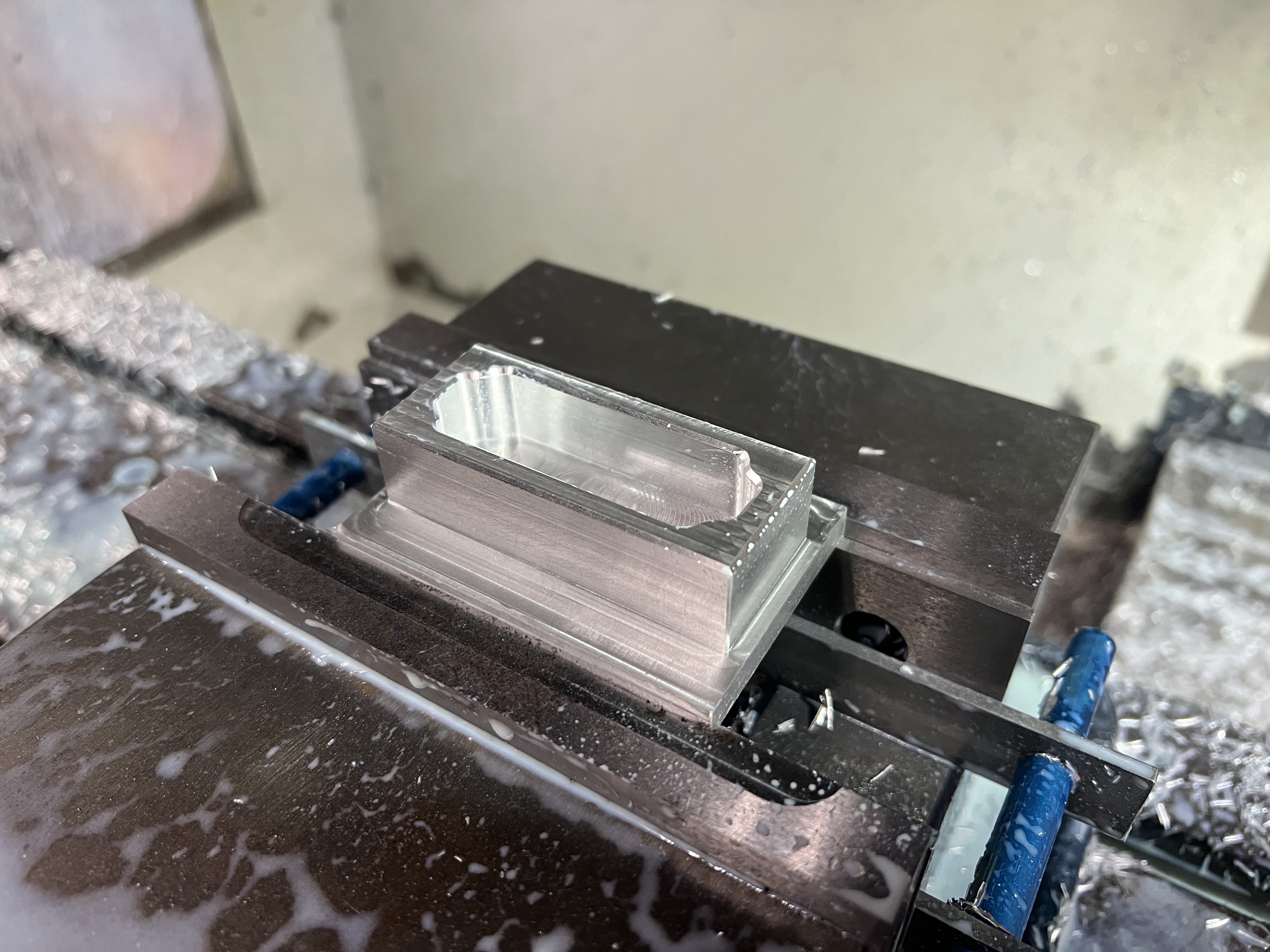

I spent all day playing with tool paths to learn what options actually did and then ran a test of this part on the Haas. The tools paths are far better after you change about 100 options from the defaults.
One setup (I didn't try to do the back), three tools, 7 tool paths, and it all worked fine.
The end result:

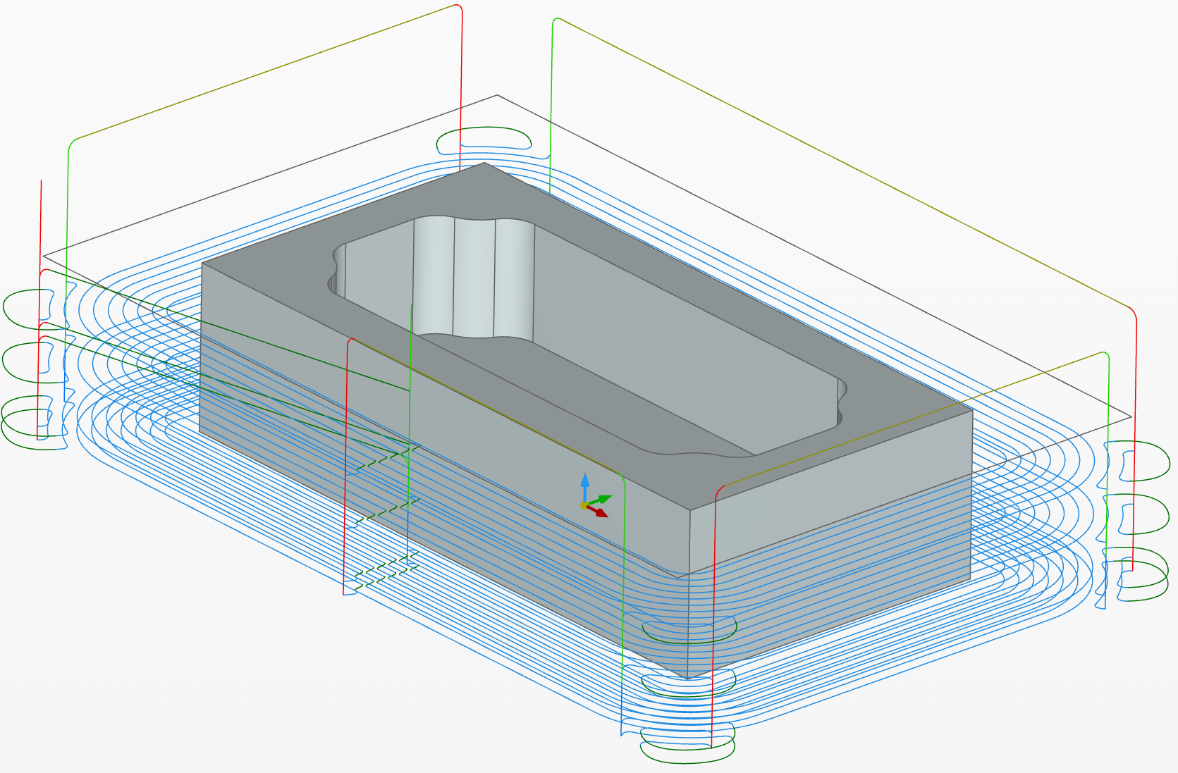

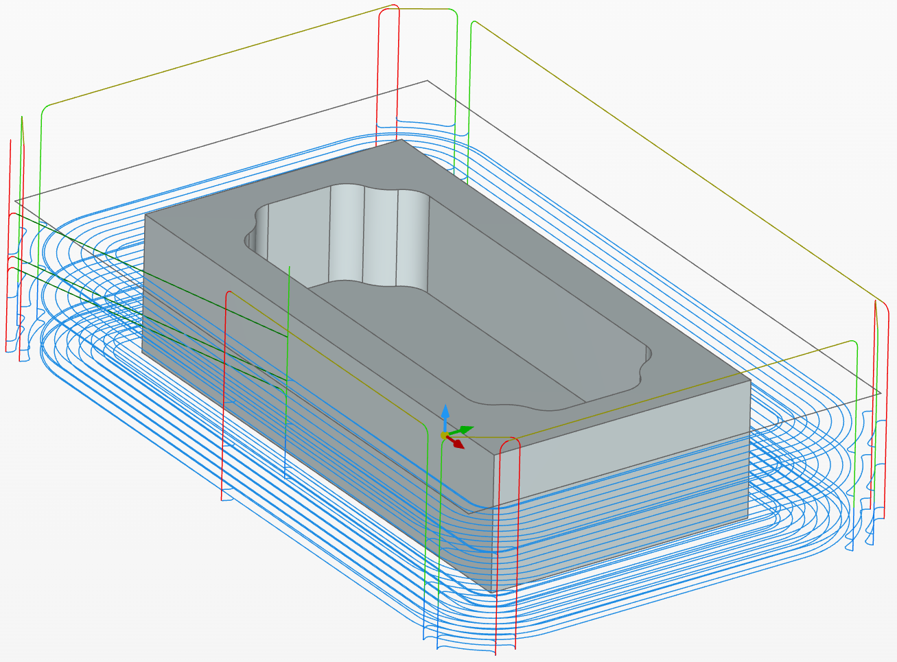

TOOLPATH ISSUE
Tool paths should never generate with sharp turns. The default facing tool path (edges/facing) did a grid with 90-degree turns. This is insane.
On big machines, a 90 deg turn forces the machine to halt a 900 lb table on a dime by slamming on the brakes at max programmed deceleration settings then turning on max acceleration on the other axes. The machine HAMMERS the heck out of the ball screws and thrust bearings and servo couplers and makes a big banging noise when this is done. Of course, the the internal software limits it to what the machine thinks is "safe," but since these machines are designed for heavy and fast production work, its limits are set high. And if you run these machines with tool paths full of 90-degree turns, it will pointlessly hammer the heck out of the machine and greatly shorten the life of the bearings and ball screws. Just don't do it. (we just spent months replacing the thrust bearings in our Haas).
This is the default facing path I first saw when running the program. Full of 90 deg turns:
After learning how to change about 10 parameters, I got it to produce what should have been a typical default with no hard turns:
Tool paths with 90 deg turns might be fine for small light table top machines that are not much more than a 3D printer with steppers, but production CNC machines should never be abused like that when it's so simple to make tool paths that have a continuous second derivative. So no sudden halts or stops or shifts in the speeds of any axis. Nothing but smooth lines. No sharp turns ever.
You also shouldn't do any sharp turns at the top of the linking from one path to the next and that doesn't show up here, but you are doing it.
There are a lot more small issues with the tool paths, but this is just a big one that irrated me that I wanted to share. But the fact I could set it to make it do what is right, was a big plus. The fact that I how have to "reprogram" the tool path logic for ever op, is not so nice.
CONCLUSION
It works!
Even for an old machine you didn't have a custom definition for, which was a pre-NGC Hass controller, CAM Studio had enough working features to get the job done!
Well with the exception of not having to stop at the lack of a drill op but I'm sure that's on your todo list.
CAM Studio got the job done. It's a joy to be able to do both CAD and CAM in the same package and not have to jump from OnShape to Fusion to do CNC work. It's going to be great when you clean up these issues and get the UI whipped into shape!

TOOLPATH ISSUE

TOOLPATH ISSUE
This issue is something that will be solved as we refine the toolpath strategies and include default settings for users. Today, the settings are in raw form and require the user to change them to refine the toolpath. The "link" section drives a lot of the settings you are looking to adjust.

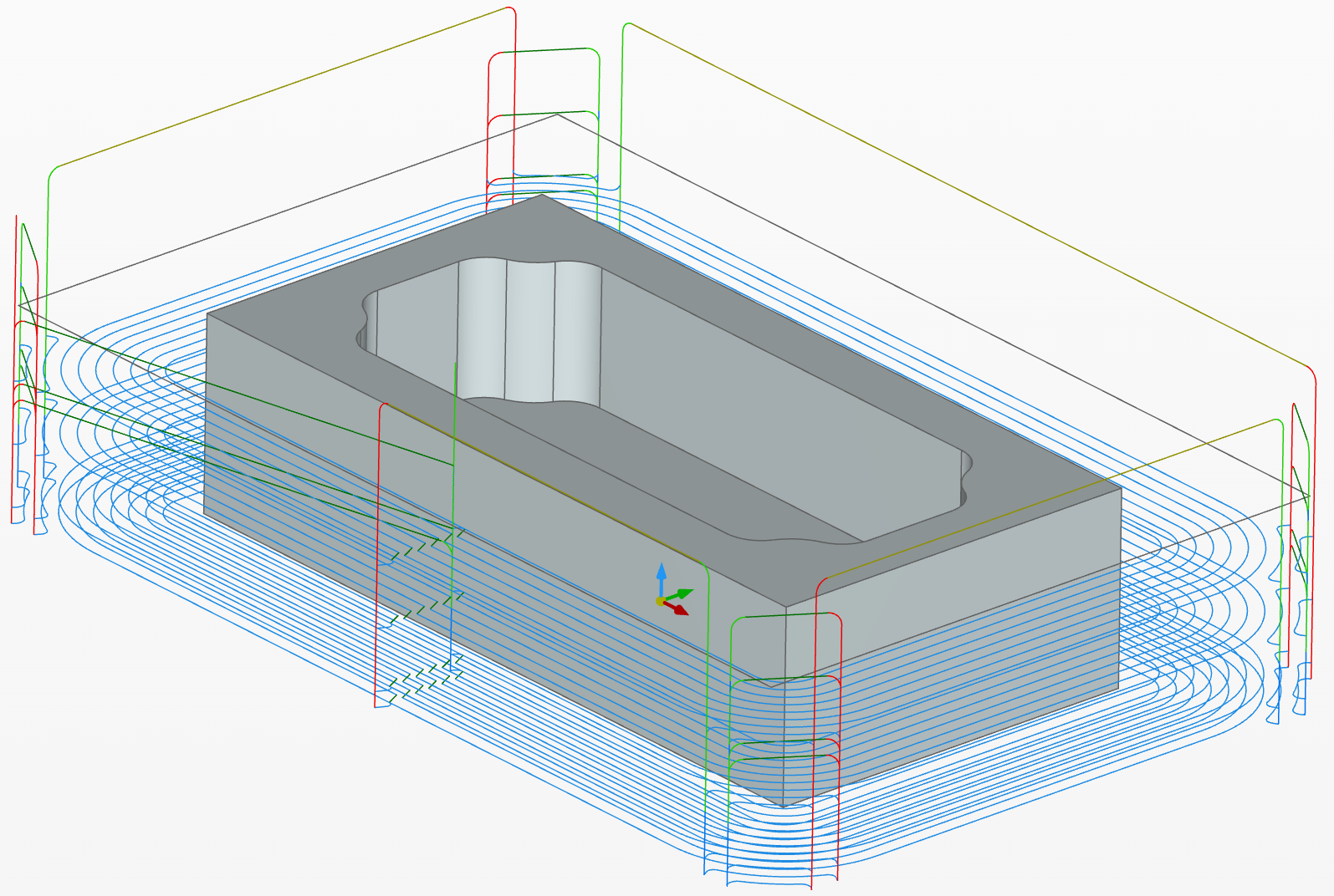

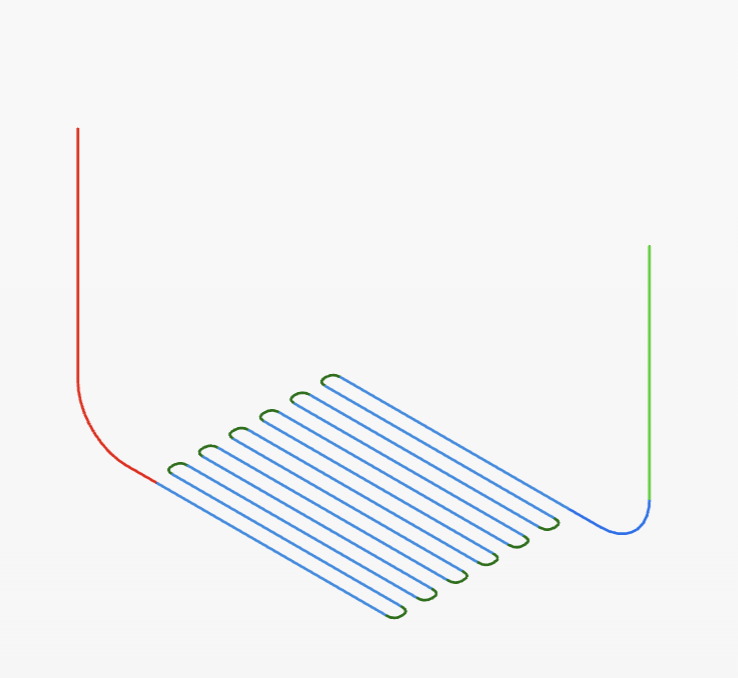

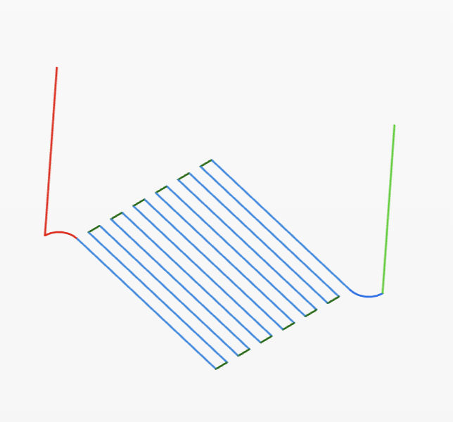

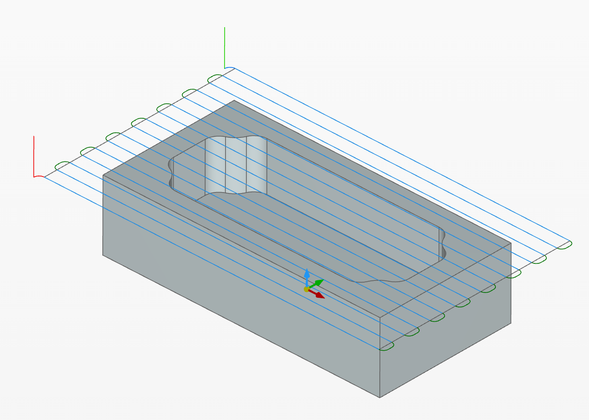

CAM Studio example
I made a replica of your model and made a few toolpaths for you to take a look at. The document is shared with you directly.
For the facing operation. I inserted a curve from the part studio for the boundary. This provides more control for the facing operation today.
I noticed in your example the helix approach is high and most likely cutting a lot of air. You can change this value to shorten the heigh for the feed in distance.

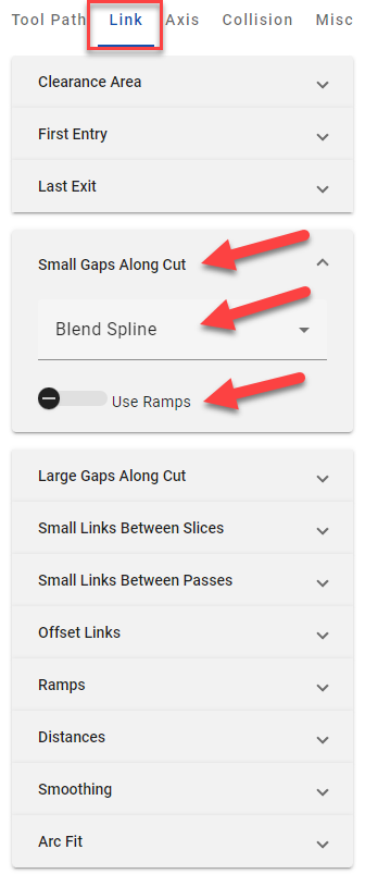

For 2 axis rough and other operations, you can change how the tool steps over between cuts instead of retracting and approaching back into the material.
Under links, change "small gaps along cuts" to bend spline, or direct and disable ramps. This will keep the tool down, and step the tool over for the next pass.
Bend spline:
Direct:

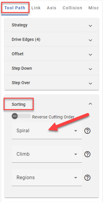

You can also change the sorting to "Spiral." This will gradually walk the tool into material as it machines the part. This prevents the tool from dramatically stepping over in the material.
Please let us know if you have any question or would like to setup a time to connect with us on a call. Thank you again for your feedback!
The fact you can insert a curve was something very non-obvious from the UI and it's what I spotted in the the first set of examples you shared. Once I understood there was a way to do that, using it to control cutting paths is an obvious solution to some of the issues I was having like facing the entire stock.

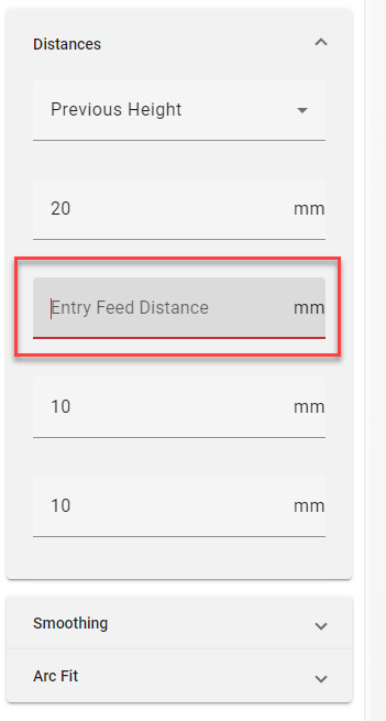

One quick question, in the above I said I couldn't find the Hole option, then later I found it and realized it was filtered out because I wasn't using a "hole" tool.
But the problem is, I had defined a chamfer mill, and I wanted to use it as a spotting (center) drill to start the holes I was going to drill with a twist dill in a follow up operation, so I did in fact want to do a drill with the chamfer mill. But CAM Studio doesn't let me do that. So it seems. Mayne I can define it as a spot drill and make the profile correct and allow me to use it? But them with the same tool I want to do chamfers. Is there a tool type that will let me both chamfer and drill with the same tool? I'll play and study this more but just wanted to though out that issue.
Fusion has a nice feature in their drill operation where the depth of the "hole" can be defined as the size of the chamfer you want to create around the hole you selected. So you just say you want a .010" chamfer as the depth specification and drill with a 45 deg chamfer bit and it makes the chamfer for you with a single plunge instead of doing a normal circular path. It saves you from having to carefully calculate the depth manually. This works well when the goal is to both spot drill and chamfer at the same time (some people say spot drilling for a 119 drill with a 90 chamfer mill is bad practice, but it works fine in practice.) But that's something for way down the road....
What I'm talking about here is a different issue. It's a bug. I just shared a document with you that has this bug in it so you can see what I'm talking about.
So I tried things like closing the window and reopening and refreshing it to see if the UI was just out of data with the back end, but that didn't help. So I think what I had to do was delete the complements that were not updating and re-add them back to the job. But then it ends up in this mode giving this ""no stock defined for job" error. I haven't iterated through all the alternatives to narrow down exactly what is triggering it, but if I work more on it and find any more details, I'll share.
