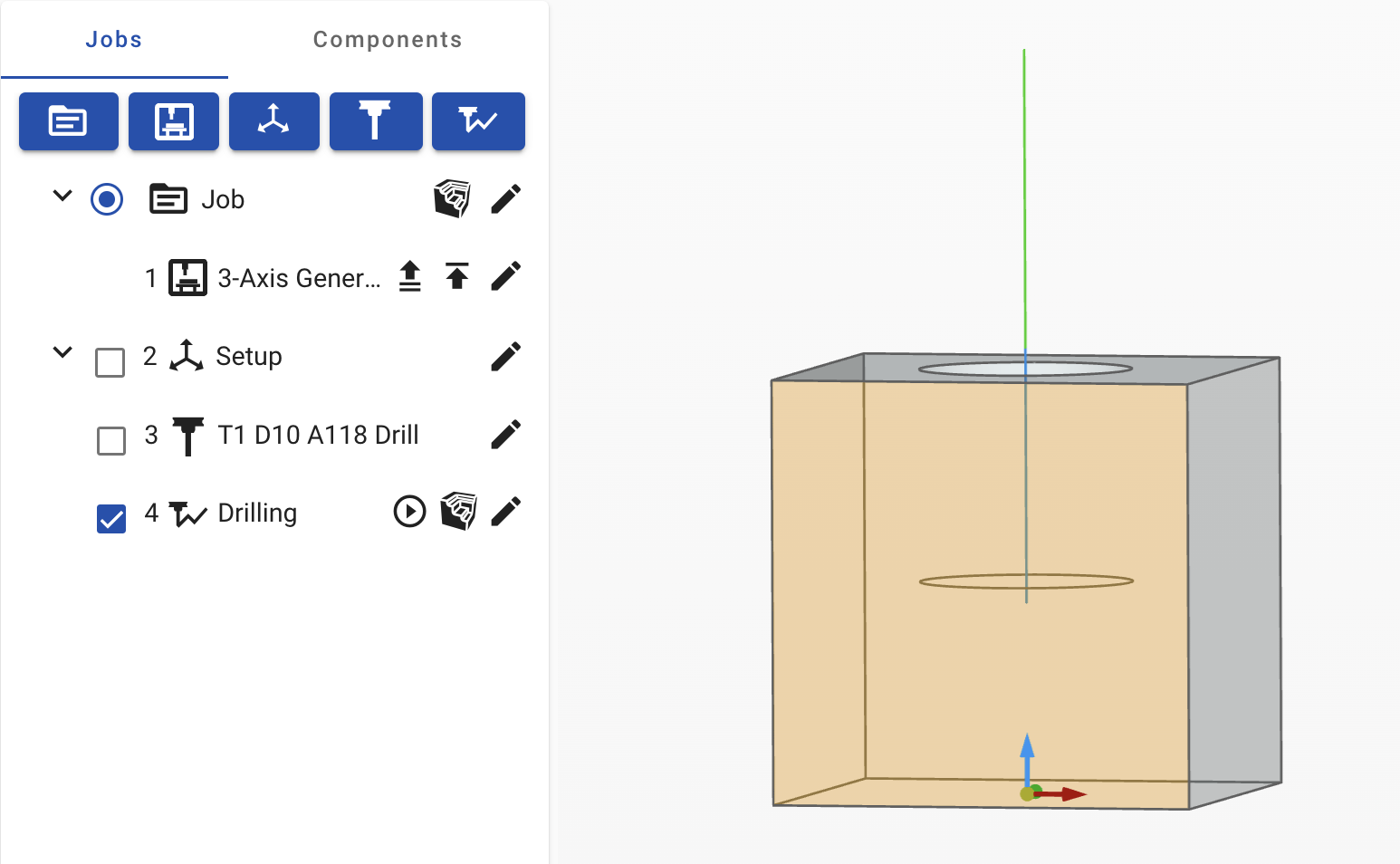

A side view of the drilling op that drills all three shows the second and third deeper than they should be:

    @Curt_Welch This is a limitation today. The drilling operation looks at the total length of the cylinder to calculate the hole. If the hole has a chamfer, the drill is starting at a lower point and causes the drill to cut deeper.  For now, I would drill holes like this separately, and make sure to adjust the depth to compensate for the chamfer.

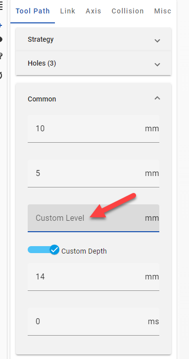

    The "custom level" setting will adjust the start height of the drill. Ideal for chamfers or counterbored holes. If you use custom depth with custom level the depth is calculated from the custom level height.

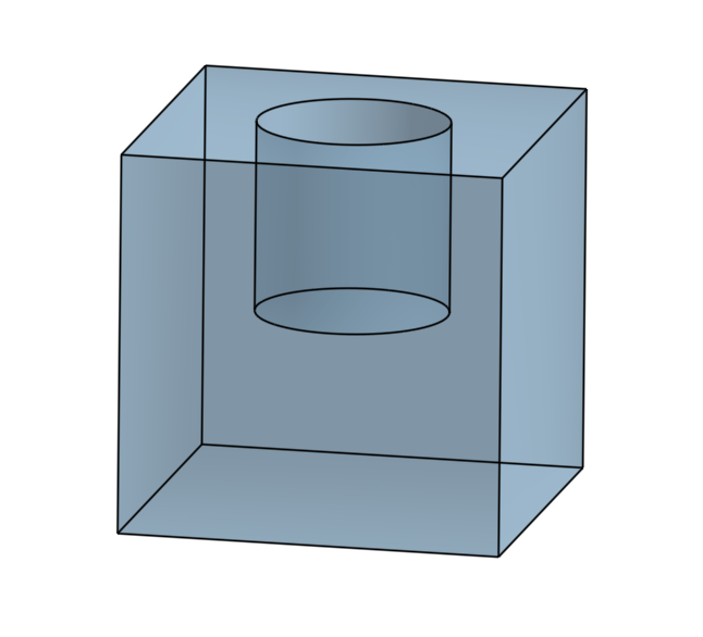

    It's all about how the body is defined in OnShape.  So here's an example of a bug in a simple block with a simple hole.
    The block is 20mm cubed with a 10 mm diameter hole 10 mm deep in the top.  Yet it drills the hole to 11 mm deep!

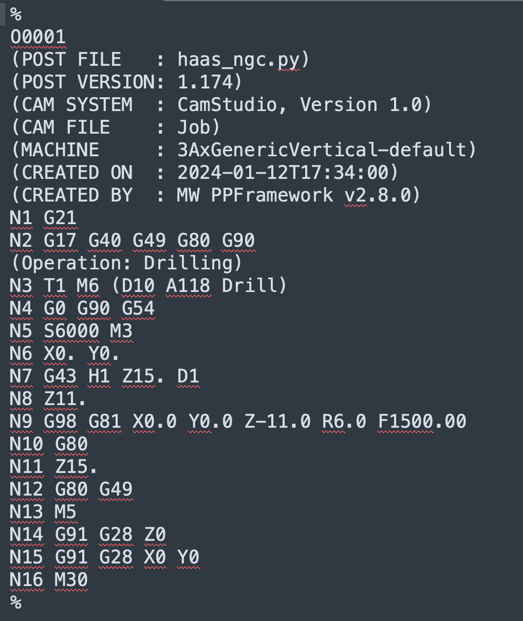

    The part zero is set to the top center of the hole in this Gcode:
    So, the reason the bug happens on this simple part seems to be triggered by how I created it in CAD.  I extruded a 20x20x100 mm tall block.  Extrude a 90mm hole into the top, then cut off the top 80mm of the block, leaving the simple cube you see above.
    When the hole is modified after it is made (with the extrude-remove in this example or with a chamfer, for example), the CAM gets the drill path wrong.  It's only off by a small amount (1mm in this example) and .1 and .2 in my other two examples), but if the hole is modified in CAD after it is defined, it seems to trigger this depth bug, even if the resulting shape is simple, as in this example.
    So, this is not just a problem caused by holes with chamfers and counterbores. It's an odd bug that can happen in multiple cases that don't look like they would be problems.

    The "custom level" you talked about above I've left at zero so far.  I couldn't figure out what it was controlling when I looked at it and played a little. But if it's the start depth maybe it can help keep this bug away?  I'll play with it.

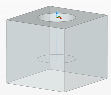

    But I was able to recreate the issue, in a Document called "Drill Bug" which I have shared with you John.
    The hole is 10mm deep but it produces G-code that drills to 11mm deep. Most other times I've seen the bug it was some random small number < 1. Like ,544mm too deep. Odd that this one is exactly 1mm off. I've never seen the error drill more than 1mm off from what would be correct so it's a small bug.
    The good thing is that the tool path is visualized to show the error, so it's not hidden. The error has always been on the "too deep" side, so the only problem it would create in real life is drilling out the bottom of a tight blind hole or drilling into a fixture, etc. But something odd is randomly happening that should not be with the depth calculation.
    Note that the start height is also always off. But while the drill is too deep, the start height is too high. So if the drill stop point is .1 too deep, the start height is .1 too high. So the total drill path is 2x longer than it should be,
    Using the custom depth doesn't make the bug go away, nor does using the custom level value.
