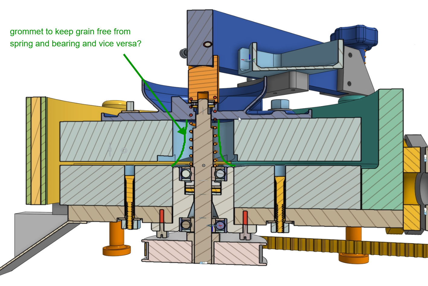

Here is a preliminary Onshape document with a basic assembly and some technical resources I’ve gathered from the Astrie design.
My first goal is a proof of concept, as low tech as possible, it could be a hand powered version, and then later, a more elaborate design that would include a motor, speed control, grain feeder and flour sifter.
Check it out and let me know if you can help, it’s on a voluntary basis for now, the design is made public as I want to share this with every home bread maker out there and allow everyone to source parts through their local market if they wish to build one for themselves, keeping the André Astrié philosophy alive.

    @jacques_spillmann I am no expert on this but it seams to that the pattern on the granite stone,s, the pressure between the stone,s , the size of the stone,s and the speed and power of the electric motor are the thing,s to get right.
    In my opinion it best to start with a mock-up where you can easely adjust these thing,s and  when you are sure all the parameter,s are good then start with the design.

    absolutely, this is my first goal, get all those parameters right. Bear in mind though that there is already a lot of design parameters that were defined by the Astrie brothers as they spent several decades tinkering with the design of their mills... so I'm not starting from scratch. The only thing is to know if using smaller diameter stones (mine is 20cm - 8" instead of theirs which usualy are ~50 cm - 20") can reproduce similar results, in other words, is the Astrie design able to scale down. I know some manufacturers of Astrie mills have gone to a 30 cm - 12" but I wonder if it can be done with the 8" size. Speed is definetly an important parameter, which leads me to think that it might actually not work do to a manual crank version as we'll never reach the necessary speed.

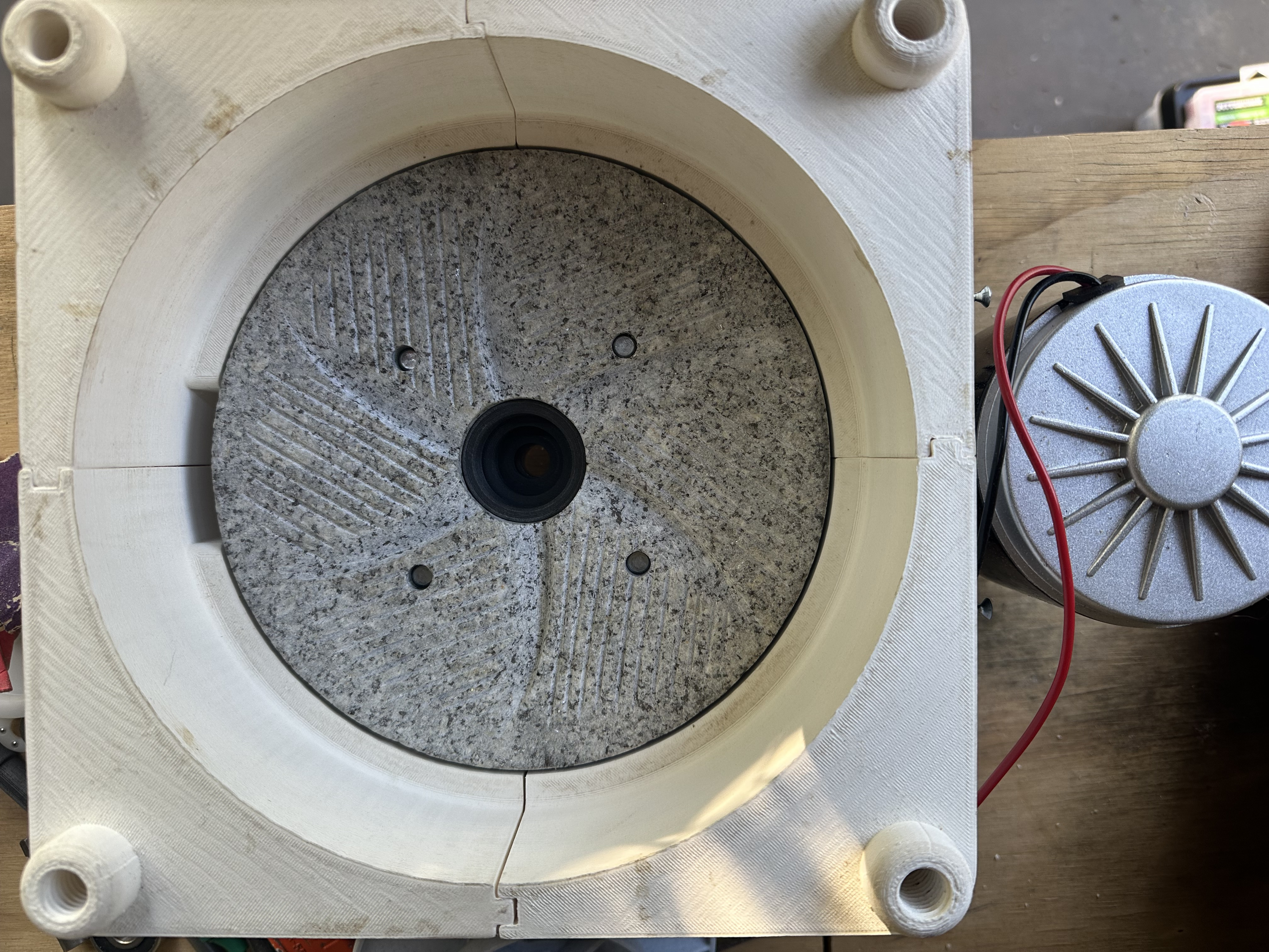

    Finally received the Millstones today, my next step is to finish the design of the first experiment and find out what speed settings are appropriate.

    I just saw this thread and opened it out of interest. wondered whether you'd want the grain to be exposed to the bearing and spring and vice versa.

    Hey Guys, yes, still working on it, it's been tested a couple of times and still need some adjustments, made a little of progress but it feels still a long way to a production ready state! Stay tuned, and thanks for your feedback! I'll add more pics/videos to the project soon.
