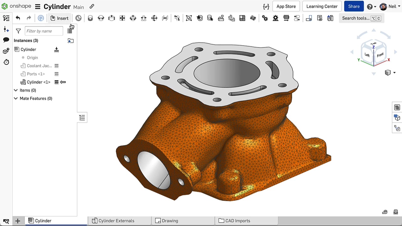

    Hello Emil. The reason you cannot Extrude Remove and only Extrude New is because it is an STL file and you cannot interact with it in Onshape. Onshape deals with solids and surfaces; Part 1 is neither. You may be able to go to the source of your file and see if it is available in another format that you can use in Onshape. Another option is to remodel it yourself; you are well on your way. Yet another option is to do a a search of Onshape's Public documents to see if it's already been modeled by another Onshape member. - Scotty

    Onshape has been able to do "mixed modeling" for over a year, wherein mesh models can be modified by parametric solid and surface features. It can be twitchy, but it does work.
