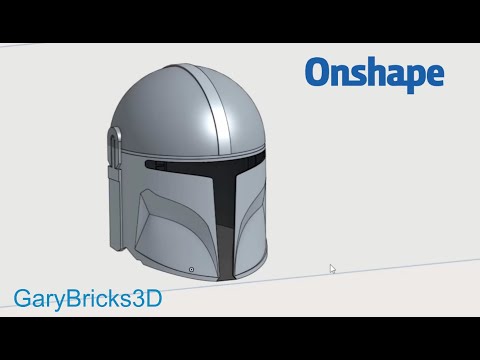

I am following a timelapse of how to create the mandalorian helmet in onshape, it is an old video and the UI differs a little, but it is manageable. this is the link:
https://youtu.be/iUQScBx-InQ?si=BBDtbfhSbmYR7PD7
I see in the tutorial, the guy created a front plane and a sketch in there, and then a right plane and a similar sketch there.
Then with the projected curve he is able to create a intermediate sketch selecting the lines, but in my case it is fails.
In the picture I am selecting the orange lines from each sketch plane, and then I hope to get the green one, but not happen.
this is the part where he uses the projected curve perfectly:
https://youtube.com/clip/Ugkx2w-rGIFo808Eq-b6FT5yFH7EVXeuEDhY?si=7Cb7_qstyrDE_H0r
What is the reason? it works for the guy with the time lapse.
thanks for your time
