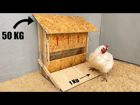

    Thanks, but thats not exactly what I want, because I would not build it like that then. I added now one missing feature that ensures that the window cant fall out:
    I got the idea from here (https://www.youtube.com/watch?v=AYzppQIstYw) and I want to build it like this.

    Matt_Shields Member, Onshape Employees Posts: 1,007 PRO
    Ah.  Then you could add a fillet to the bottom of the window to make it round and then add a Tangent mate.  Or if you don't want the window to be rounded, add a hidden round surface and use that for the Tangent mate.

    thomas_ritter031 Member Posts: 6 ✭
    ahh, yeah, very nice. Added the filet and did it with the tangent mate. thanks you very much :D
