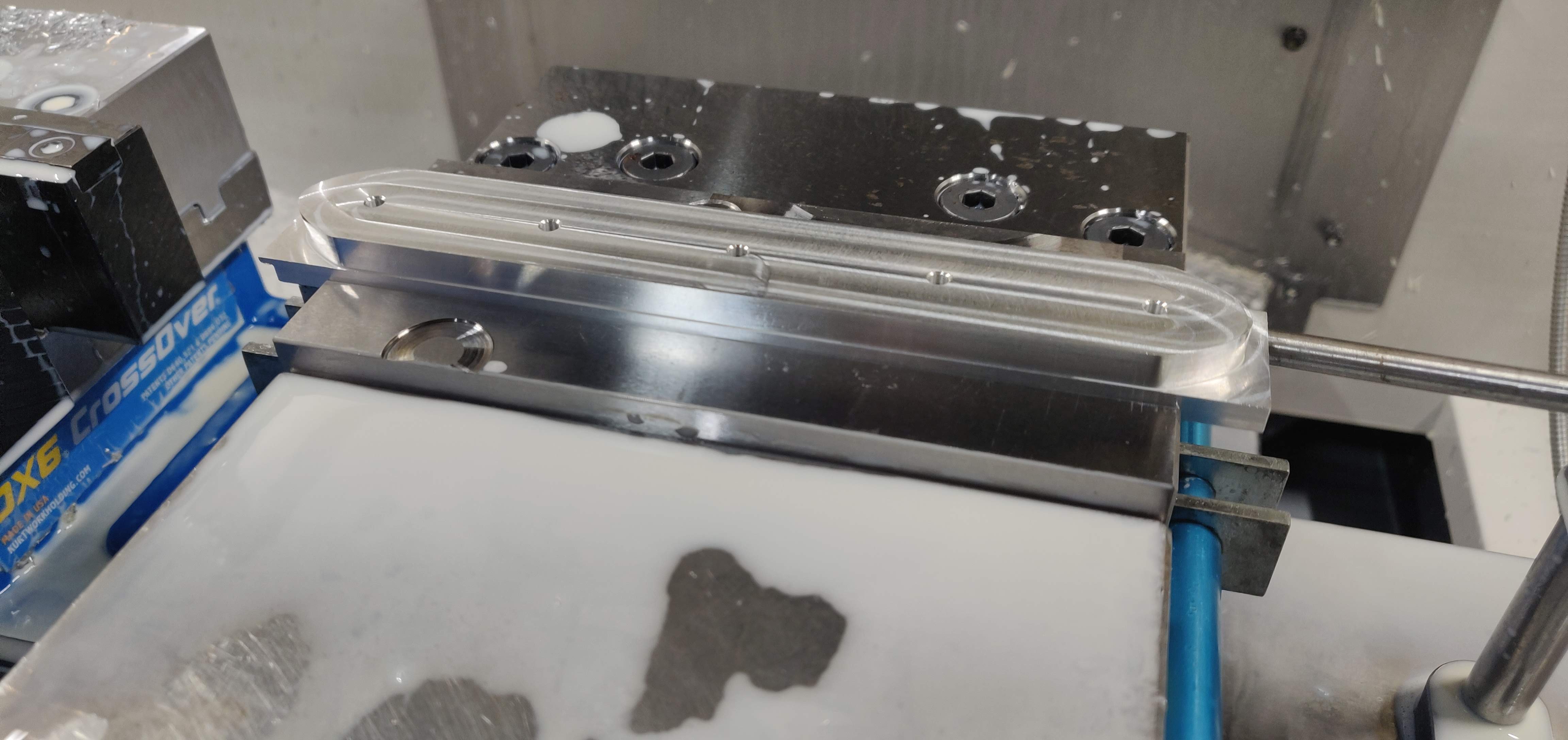

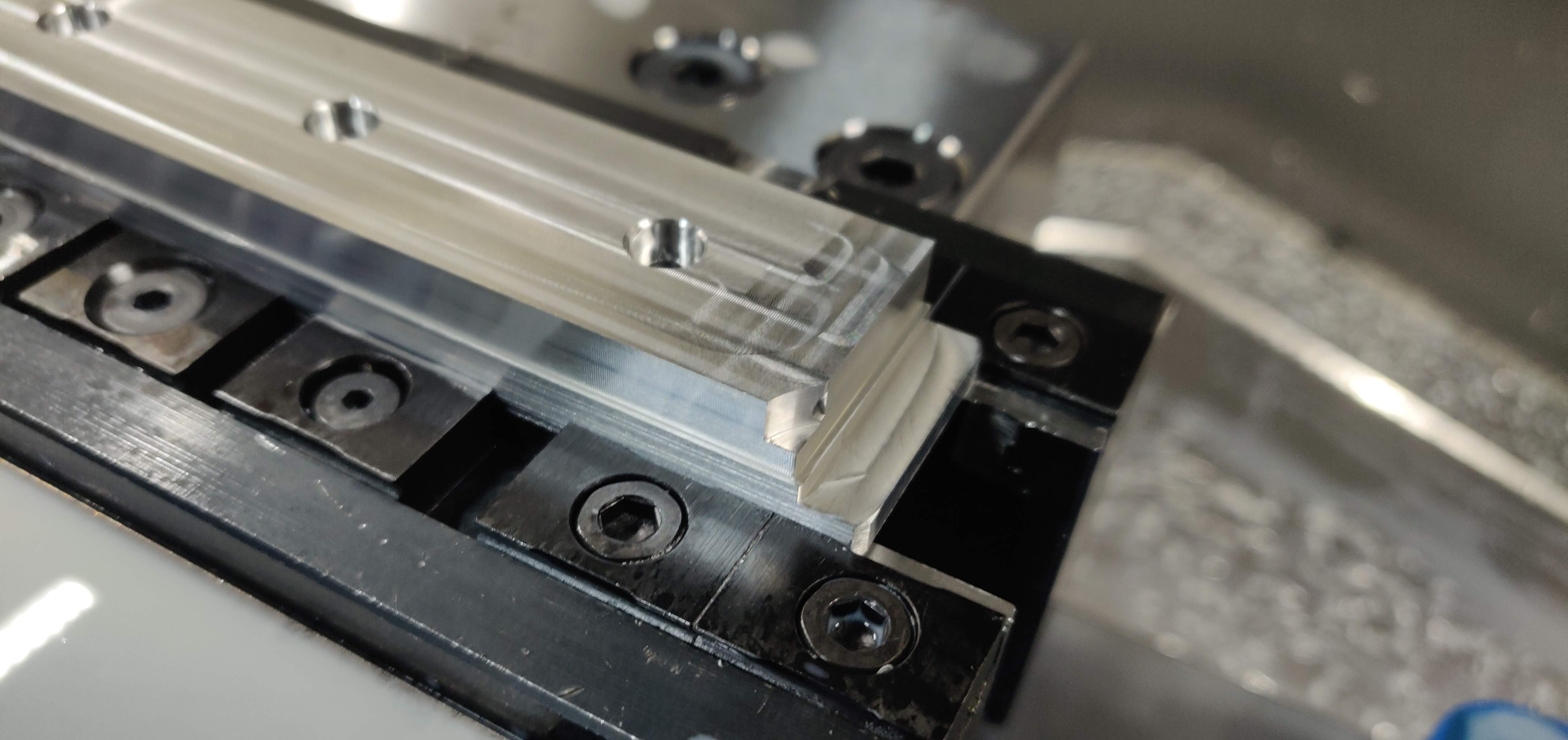

I finally got around to making a part. This was a simple 2 1/2D fixture.
Pros: I like the toolpaths. They can use some work for usability, but I like the flow. It is not there yet, but I can see a point where there is not a lot of clicking. Copying or templates ability could be incredible!!
Cons: It was pretty difficult to deal with the posts. I had to rewrite the tool changes. I did have one digger, but I think that was my fault rewriting the post. It took way too long...

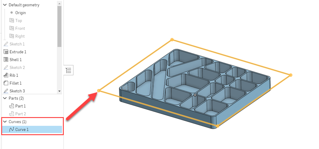

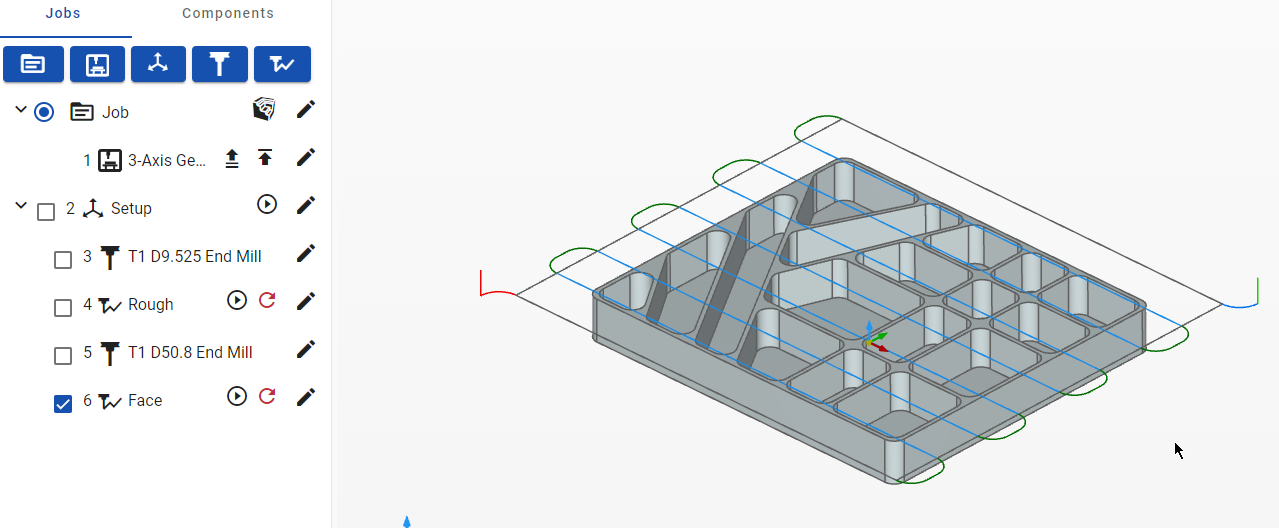

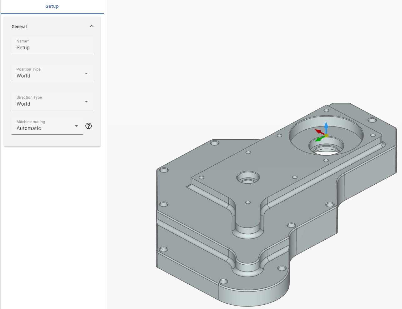

    @wayne_sauder In the part studio, sketch a rectangle over the part that you want to face. Create a composite curve from that sketch and insert the curve into cam studio. Next, create the facing operation from that curve. Hope this helps!

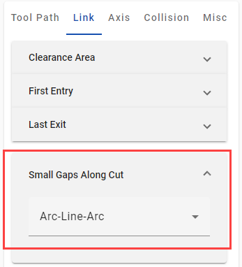

    One additional note. In the links section, you can adjust what the tools does between each pass. In the above example I changed small gaps along cut to arc-line-arc.

    @wayne_sauder The ability to define multiple work coordinate systems is not yet supported but is part of our plan to revamp setups and datums in the coming months. This will include support for multiple wcs, and their corresponding identifier G54, G55, G56 etc. Today, cam studio can only define a single wcs off of a bounding box point or the world origin of the part from the part studio. In the setup, you can define this box point but cannot attach the wcs to a part feature. A workaround for today is to transform the origin in the part studio to the feature or location you want to use for the wcs. When the part is brought into cam studio, the model origin will be the wcs.
    Using this part as an example. In the part studio, I transformed the origin to the top center of a feature.
    In cam studio, the origin is used for the setup.

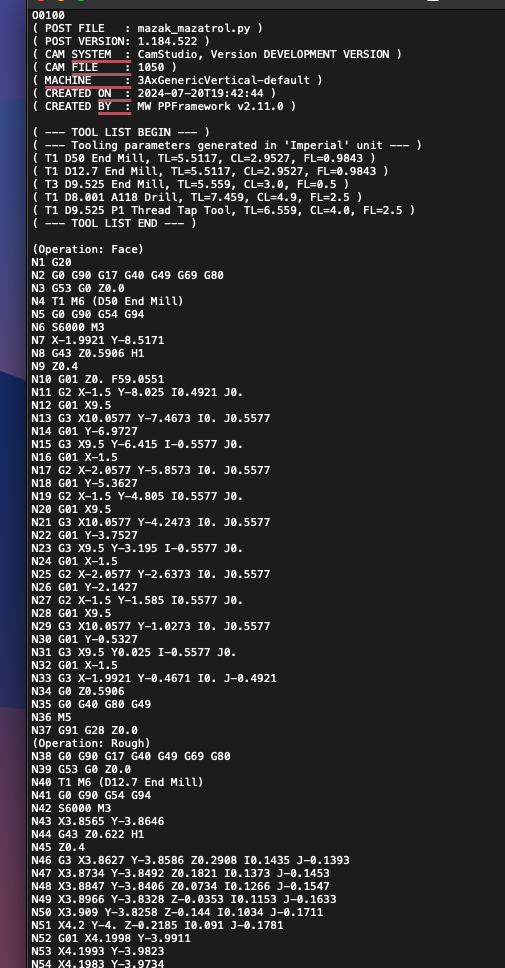

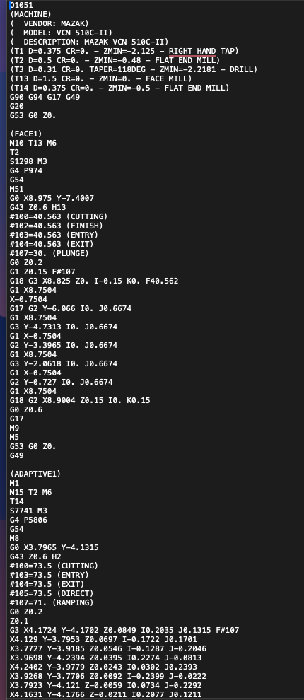

    Here are two screenshots (same part), one from Cam Studio and the other from my standard settings in Fusion. The complete EIA programs are in the document that I shared with support. Note the G4 P*** is a result of my customized post; without this, the machine starts the spindle and rapids to position without allowing the spindle to get to speed. (Results in broken tools.  :s )
  • John_P_DesiletsJohn_P_Desilets Onshape Employees, csevp Posts: 267 image
    @wayne_sauder Thank you for sharing this with us! I will take a look at the support ticket shortly. As for the issue with you machine not reaching full spindle speed before cutting. Have you tried to see is there is a parameter that checks if the spindle speed has been reached before moving?
  • wayne_sauderwayne_sauder Member, csevp Posts: 632 PRO
    @John_P_Desilets
     I have not, good idea.
     We have an older gentleman who works on our machines (he used to be a Mazak tech), and this is what he told me to do. But it would probably be a good idea to check with Mazak and see if there is an option like that.
     I'll check when I have a moment.
