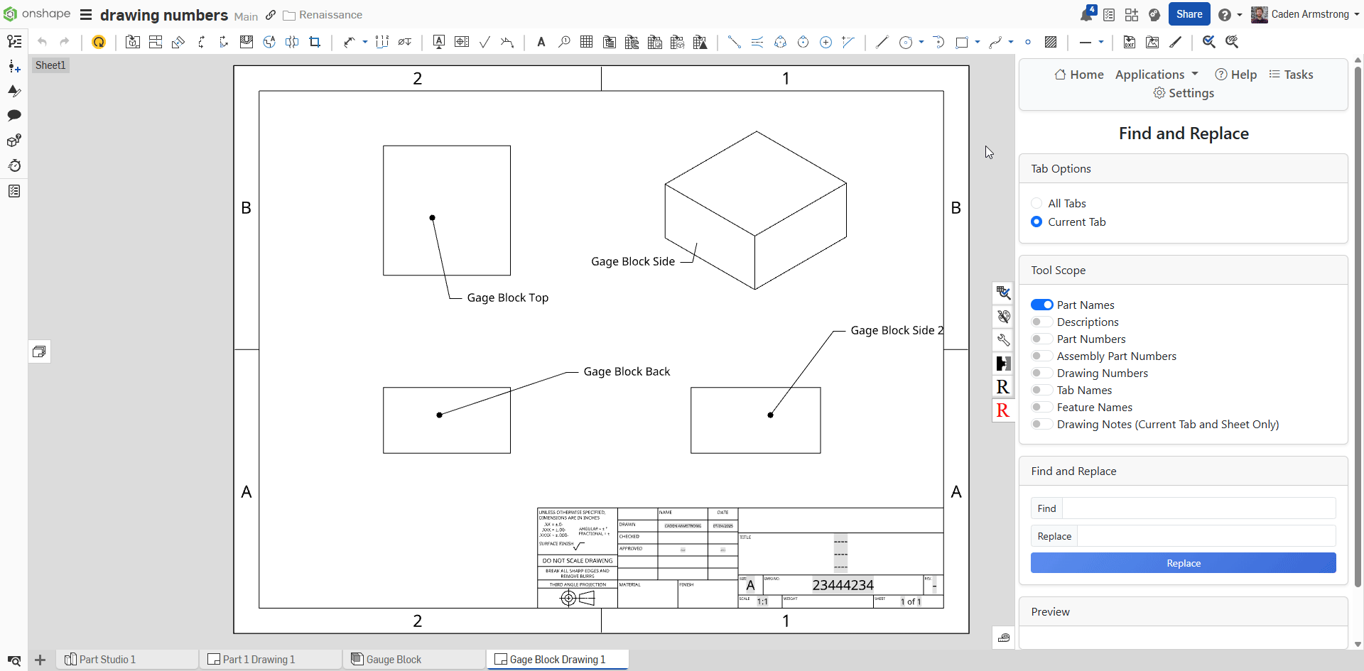

Find and Replace
This new tool lets you do a ctrl-f replace across a document.
Find and replace feature names, part names, tab names, descriptions, and part numbers.
This tool works within a single tab or an entire document.
Useful for keeping organized data when creating document copies.
The preview lets you make sure that all your data will be correctly updated.

- Find and Replace now supports notes in drawings
- The Magic Drawings app supports copying the part number to the current drawing from the referenced part
