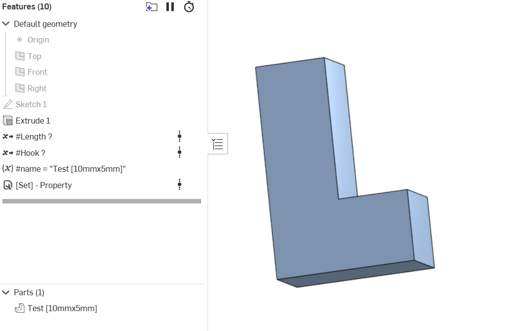

Set Property (New Custom Feature!)
Set Property allows you to:
  • Dynamically set the properties of your part or multiple parts.
  • Set custom properties.
Tips:
  • Custom property ID's are found in your company settings.
  • Right click on any value input to convert it to expression. This means you can use variables to drive the values.

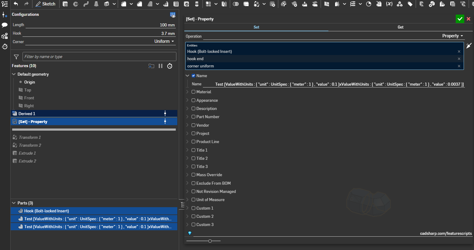

    Hi @MichaelPascoe and thanks for the script ! Maybe I'm doing something wrong but when using the script to change the name of a part whose name had previously been manually changed, it doesn't work.
    https://cad.onshape.com/documents/d46d641aba26104e94b70a37/w/5a96188877debc677f6c3507/e/c137d8b212e42c0fb242f04a
    I can get the name to change and make that dynamic by linking it to variables and so on, it all works great. Just not if I previously name the file manually which is the case most of the time as I don't necessarily plan in advance to need to configure the name.
  • Pattabi
    Pattabi Member Posts: 54 โœญโœญ
    @Jon_H You can click on reset all in the properties tab. Then it works see the video below.
  • Jon_H
    Jon_H Member Posts: 38 PRO
    Thanks @Pattabi_Kakumanu for the workaround ! At least this restores the script functionality, but it also clears all the other properties which then need to be manually re-entered, not very practical. I hope there is a way for the featurescript to detect that it needs to reset the name property and that it is possible to reset only one field.
  • MichaelPascoe
    MichaelPascoe Member Posts: 2,968 PRO
    edited March 2025
    @Jon_H Currently this is one of Onshape's limitations. FeatureScript is unable to override manually set properties. Resetting the property like Pattabi showed, is the only way to reset that specific property to allow FS to set it.

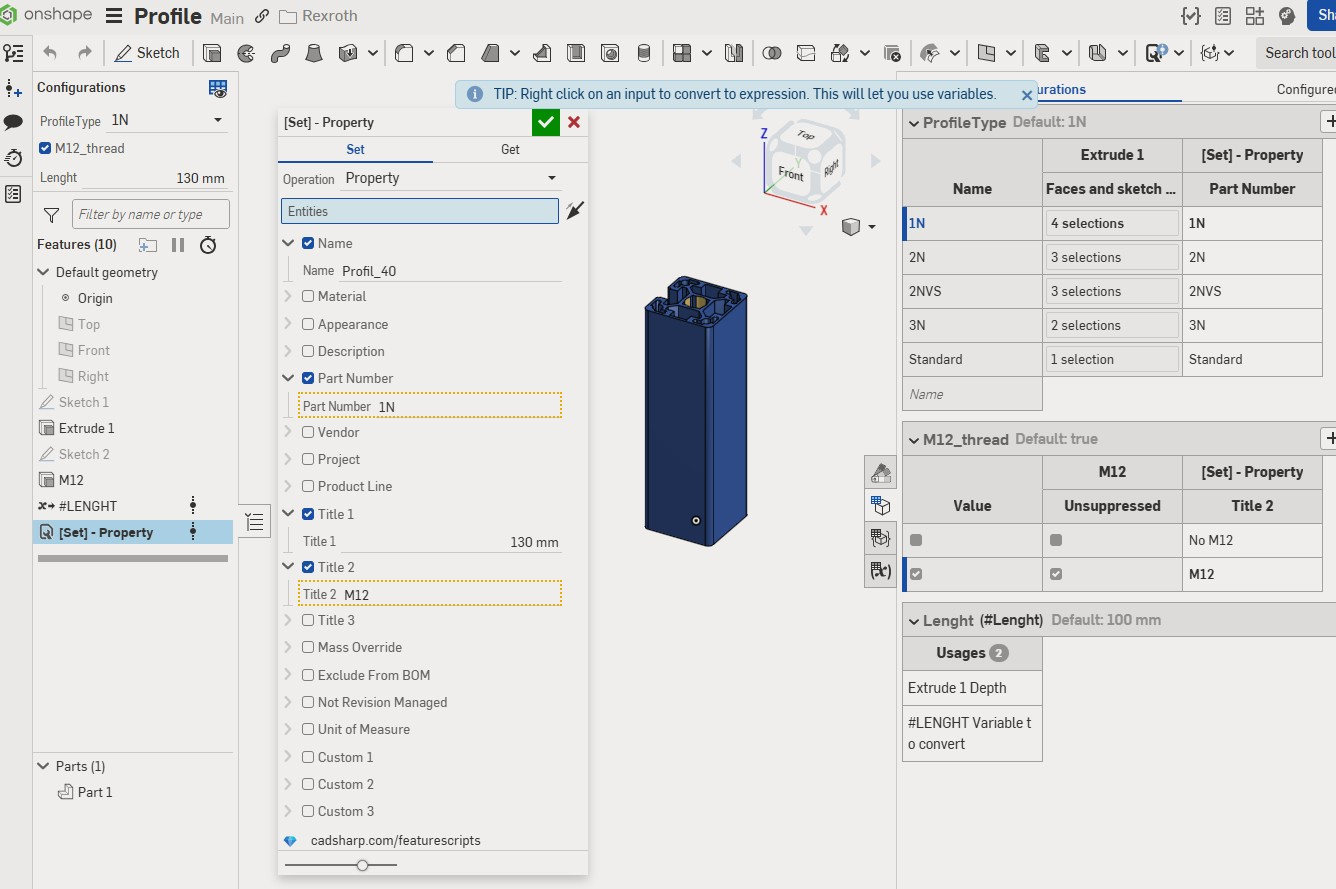

  • Richard_Inv
    Richard_Inv Member Posts: 45 PRO
    edited July 2025
    Is it possible to get this to override onshape's Configured Properties?
    I've set most of my part's properties with Configured Properties (as different part sizes have different part numbers, descriptions etc), but I want only the name to be controlled by this script (I'm using your Convert To String custom feature to achieve this).
    In the example below, I'd want the part name to be '125mm' which works perfectly if I clear the Configured Properties, but gets overridden if I don't. Even though I haven't used the Configured Properties to set the part name
  • MichaelPascoe
    @Richard_Inv Once a property has been set manually, you have to clear all properties in order to reset it to allow features to override the properties. It would be nice if we could override, but properties are outside the scope of the feature tree; which is probably the reason we have to manually reset the properties. Having the option to reset only one property would be really helpful.
    Are you saying that even if you don't configure the name property, it will not let you override it unless you reset all properties?
    I recommend clearing all properties and using the Property / Attribute feature to control all of them. This way you don't have to mess with the property configuration panel. If you need help with logical statements, let me know and I can give some quick tips or take a look at your document.

  • paulpat1000
    paulpat1000 Member Posts: 3 PRO
    I think I'm misunderstanding something fundamental. I wish use this awesome tool to set part properties where the part belongs to a configuration scheme. I had previously come to a conclusion that this doesn't work. Now I am unsure.
    My understanding is that a part property is either (1) set for the entire configuration group (all configs) by right-clicking the part and setting properties there (eg all parts are from Vendor X); or by (2) the "configured properties" table that can individualize the properties on a per-config basis (eg vendor part number for config Y). Furthermore, I understanding that the SET feature here basically automates method 1. But this means that a property set this way will effectively apply an individualized property to all configurations, which of course is not the desired outcome.
    I'm pretty sure I'm missing something and would appreciate being corrected.
  • MichaelPascoe
    edited July 2025
    @paulpat1000 The Property / Attribute feature is for setting properties without having to use the "configured properties" tab. I found that the configured properties tab doesn't work as I would like. Setting the properties with this feature allows the feature to be configured with normal configurations instead of property configurations.
    If you want to control a single property input with more than one configuration input (ex: A list as well as a variable as well as a checkbox), then instead of right clicking the input and configuring it, you would need to have the different configurations drive a variable or multiple variables and then use that variable in the Property / Attribute feature.
    If you share an example document of what you are trying to do, I will show you how to implement the Property / Attribute feature for your document.
