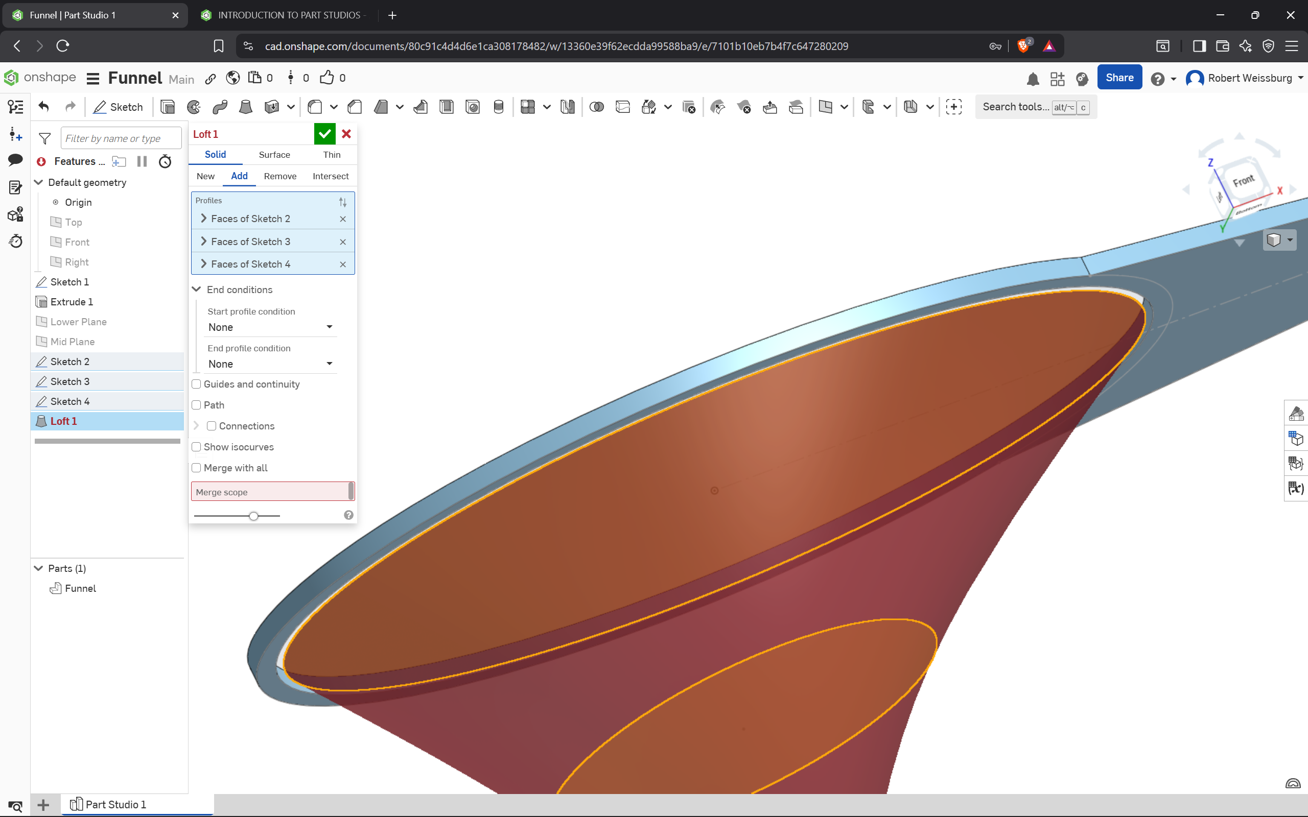

    I was asking about this in my own thread, but Matt linked me here. I have tried about 50 ways of doing this and nothing works any better. This is the result from having disable imprinting checked. I always select the sketches from the list, not the drawing. It just never connects the funnel to the rim.
    I don't really understand what Matt is saying in his comment above, "It's really hard to grab the right profile from sketch 1 without also grabbing the inner loop."
    What's the inner loop? The inside edge of the rim's lower surface?
    If I rotate the drawing to look at the lower face and move my cursor over the rim surface (or handle), either the inner edge of the rim is orange, the outer edge, or, if in the central region, both are orange highlighted. I've tried all. I assume it should be both, apparently meaning your are pointing at the surface (I'd think the surface would turn orange, but this never happens).
    The offset ellipse generated is aligned with the lower plane of the rim, so that appears to be what is wanted in this step.
