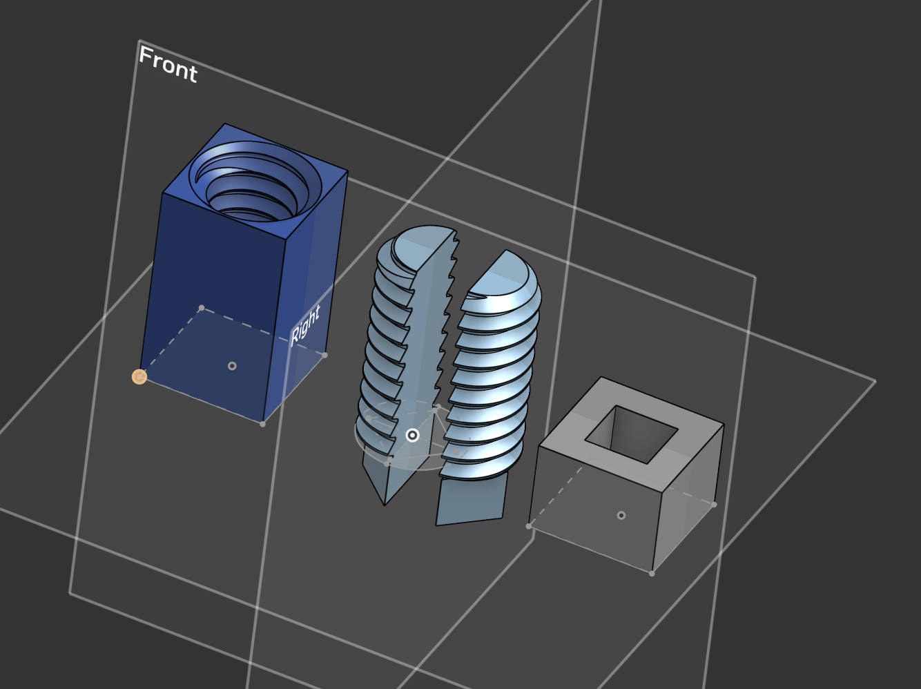

If you have a bolt and a nut you can easily select both and create the same threads on each in one step.
The tolerance between both internal and external threads is handled right away by the script:

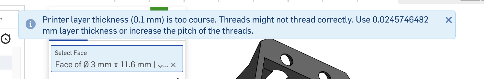

    Two issues which arise as I use it:
    1. It complains when the layer resolution isn't quite fine enough for the requested thread. That's good to have some feedback, but as things stand there are two improvements I would ask for: 1) don't elevate the issue to a failure. It's not great to see red in the feature tree, and this wouldn't seem to be that critical. 2) If the script knows what the max acceptable layer size is, it should communicate that to the user, as otherwise the user will have to guess to find the right layer size
    2. There's some kind of weird overrun issue I'm seeing when I choose a cylinder to thread. You can see in the below screenshot where the selected area is the cylinder in orange, but it knocks out a huge cone from the part (removed sections in transparent). This is a showstopper, and I can't seem to find a workaround in the part studio.

    Hey @kenn_sebesta167,
    Thanks for the comment and recommendations. I'm sorry I didn’t get back to you sooner. I haven’t looked at the forums in a little while.
    I changed the layer thickness error to show up as a tooltip and to show the “correct” layer thickness. Of course, by “correct” layer thickness I mean the layer thickness ensuring that a single layer captures the flat section of the thread profile. This is an estimation of what would work and in my experience, it prevents tiny threads from printing with too little detail/resolution.

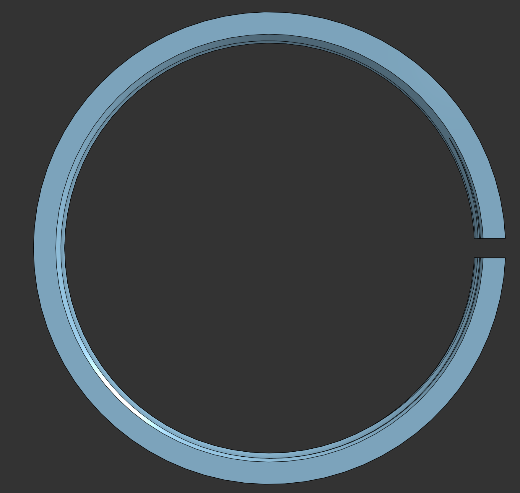

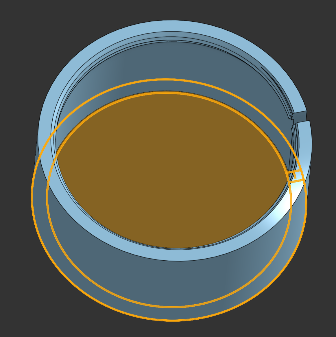

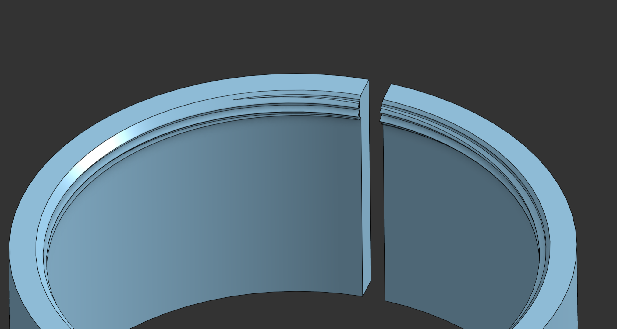

  • cdaringe
    cdaringe Member Posts: 2 ✭✭
    Hi! Thanks for this super cool project. I may be missing something obvious, but I couldn't seem to not have interference. In part studio I gen'd up my male & female parts, threaded them up, then over in the assembly rotated (see attached). EDIT: oh, for both threaded surfaces, I couldn't flip the direction independently—I think that's the root of my problem. Ya— I have a 28mm thread in a 30mm slot, creating a 2mm bolt head. However, that "head" is at the opposing end in the female threads! No worries—i'll just thread 'em indepedently.

    Hi @cdaringe,
    That's a kind of limitation with the code right now. You have to separate the thread creation to rotate them independently. I could add a feature to edit the properties of the threads independently, but it would be somewhat useless and confusing.

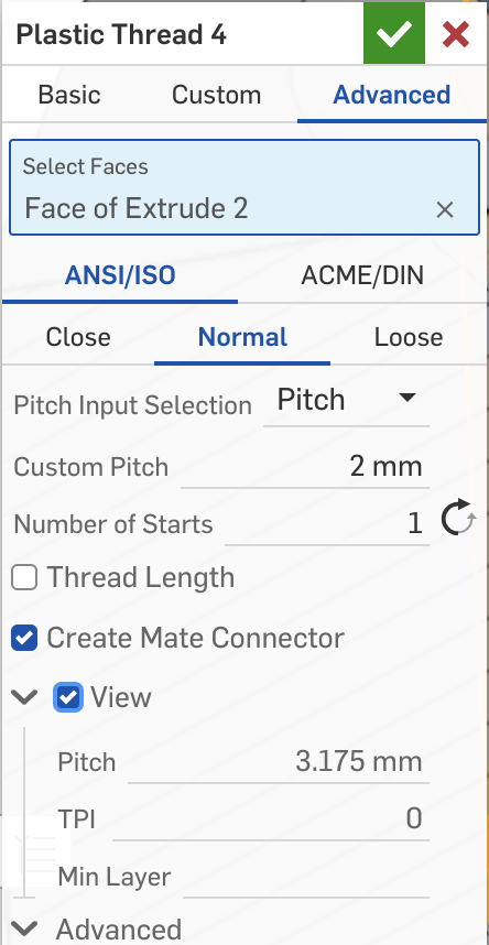

    @william_knoblauch
    Thank you that works if entry unit mm.
    Another question: in the view section, what is this Pitch value 3.175mm

  • william_knoblauch
    william_knoblauch Member Posts: 25 ✭✭
    @patrick_monnier That shouldn't show up when you have specified a custom pitch/TPI for your thread. It won't do anything because it's just displaying the pitch it would use, given the diameter of the cylinder you selected. To my understanding, there can be some mismatches between that display and the current state because I'm using a viewEditLogic function to dynamically update that info, which can get out of sync with the current inputs easily.
    The idea behind that view menu is to see that info in basic mode, where the pitch/TPI is automatically calculated based on the cylinder diameter. The layer thickness is useful in every mode because it shows what the "minimum" printer layer thickness is to achieve a good print. The only problem with the layer thickness is that it's a naive calculation that assumes that to get a good print, the smallest detail on the thread needs to be equal to the layer height. In practice, this is not true. I've printed some M3 threads with a 0.16 mm layer height and got around the thread-detail issue by up-sizing the hole. There's also a button to do that at the bottom of advanced mode called "Increase small hole tolerance", which should do that for you.

    Hi @william_knoblauch. Thanks a lot for the feature.
    However, I have one problem with internal threads. I designed a container based on two circle and added a thread to the two parts. As I require a slot in the container, I noticed the threads create an extra wall, although I specified that the threads should have a length of 5 mm. Any way to avoid this (except for splitting the cylinder into two parts?
